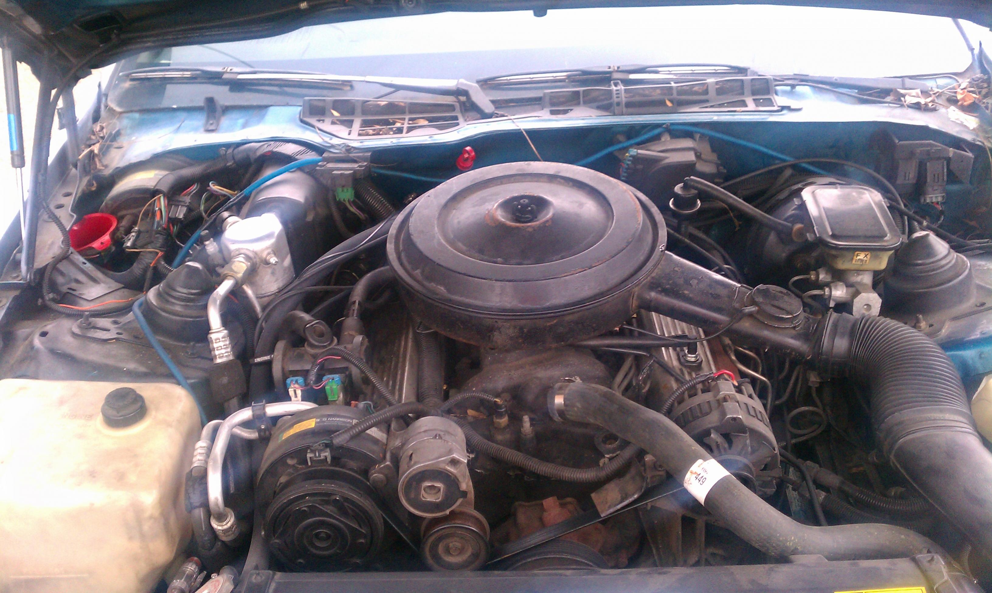

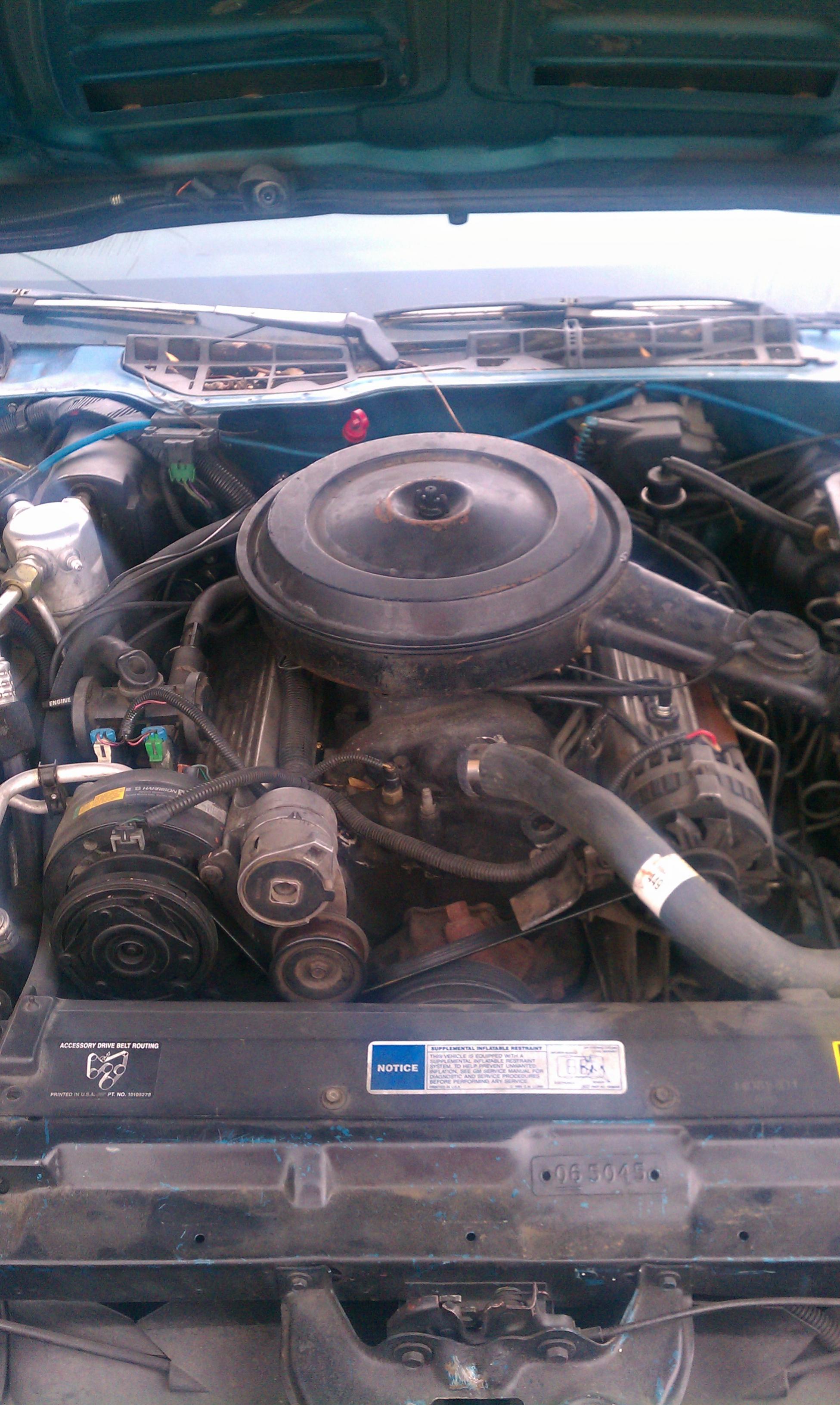

to be honest it doesnt have to be a tpi set up i just feel like the car is a little sluggish and feel like it may be from lack of air (seems to run a little rich) i actually preffer the look of an open element air cleaner how ever failing smog becuase of this heat stove piece being gone has really drove me nucking futs and i thought it would make things a liitle more simple in the future.... it would also help if i could clean the engine bay because there is stuff everywhere and it is a little overwhelming, connections not hooked up to anything, wires exposed... it doesnt seem like the intake on there is not sufficient enough for the 5.7 in there i will post pics for all to see in a minute

yea find the heat stove was the first thing i looked in too except i cant find one anywhere. i thought about just trying to make one for the time being to get past smog cuz that is the only thing that failed i think the guy was just being a ***** lol i guess thats his job and he takes it seriously.. i will be looking into headers soon all opinons seem to say i dont really need to do intake swap so i think i will listen to that cuz i didnt really want to do that anyway.. good advice here are some pics of my engine i know it needs a lot of work
