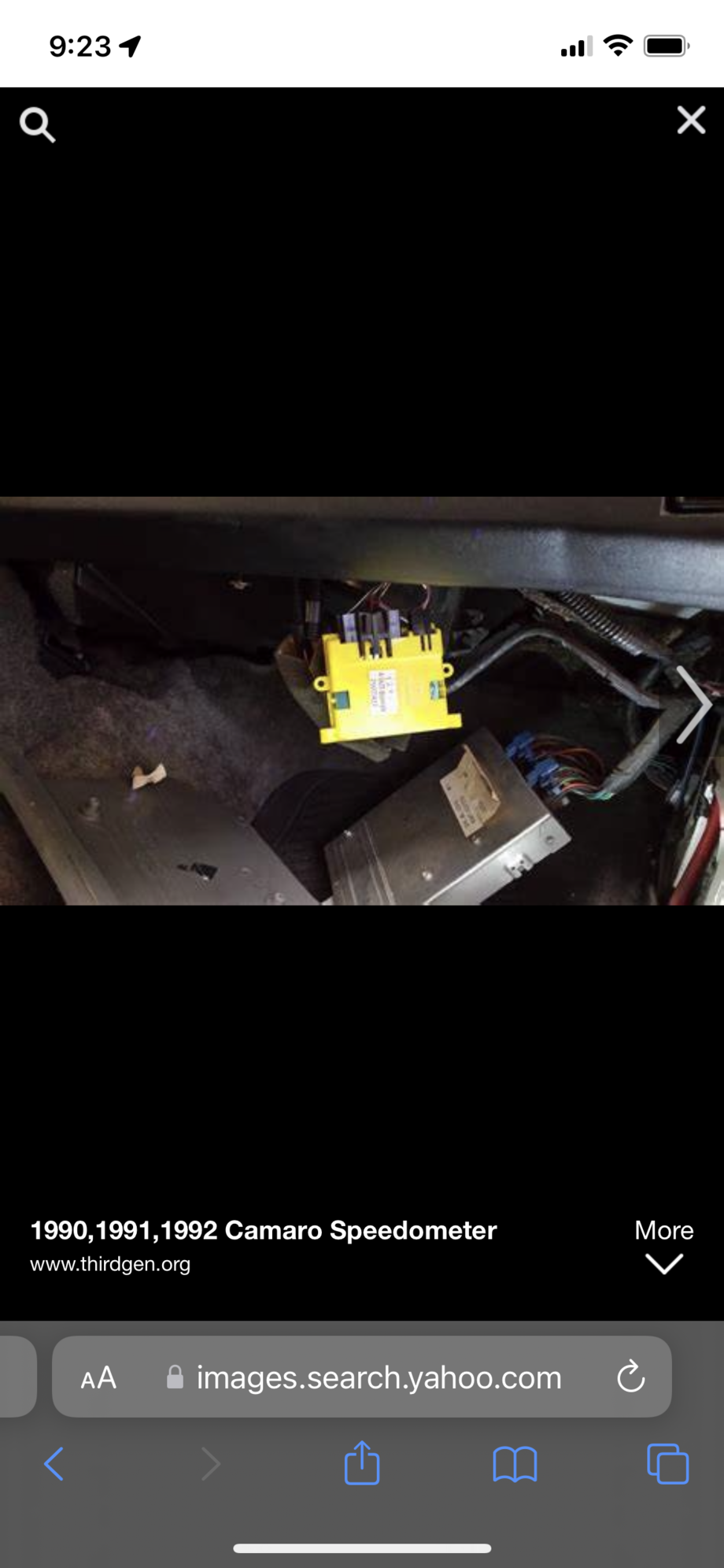

One quick question, where is that VSB or buffer box located?

It's a bright yellow box near the ecm. Wires from that harness need to go directly over to it.

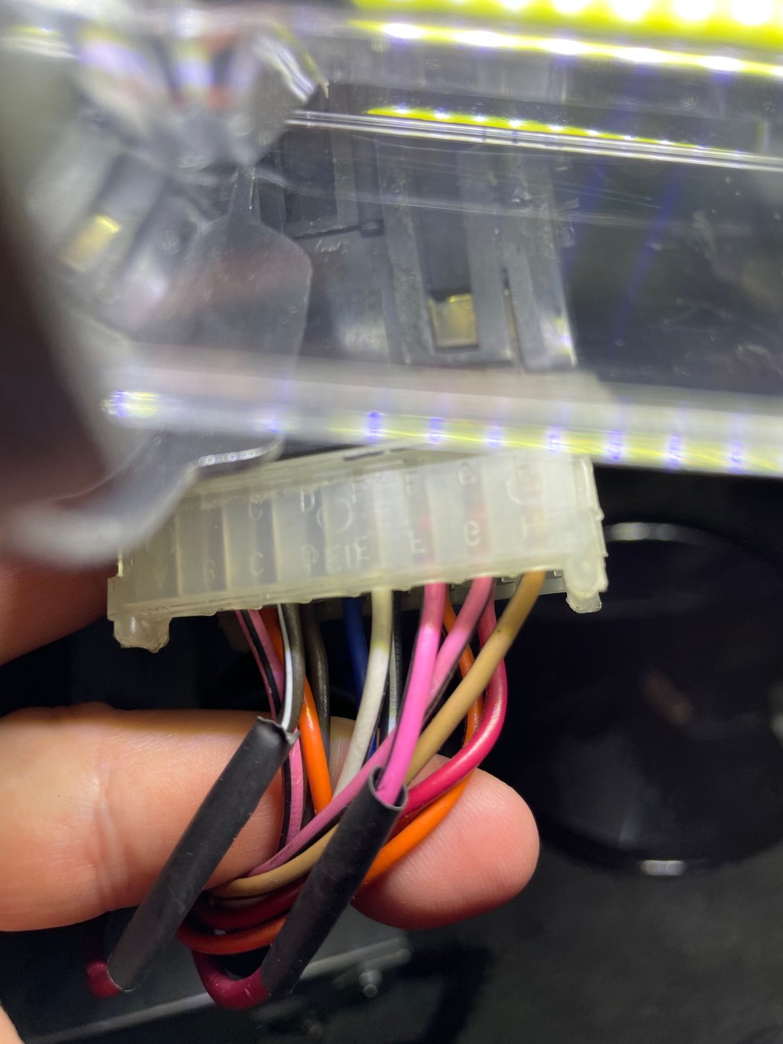

Moved gray wire from D to K. Also someone wrote to crest a u from C to F. Are we doubling up on wires. Speedo and odometer are currently not working

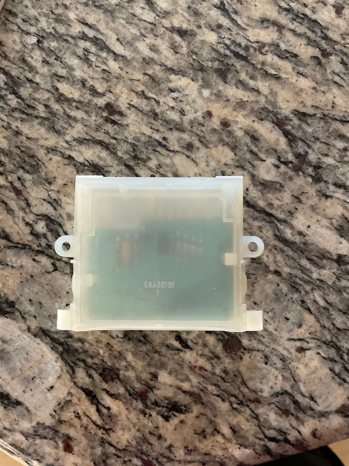

Mine is clear? Is this what I’m looking for. Might be the reason I had a hard time finding it
