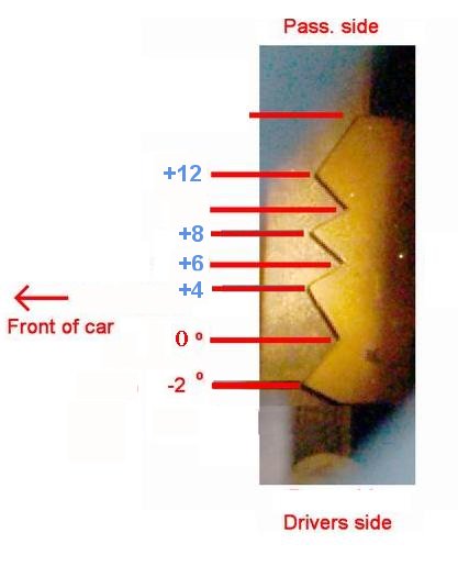

Timing is set with car idling in park. EST is on the passenger side firewall. Brown wire with a black stripe. It will be protruding out of the harness.Set timing to 6 degrees BTDC.
