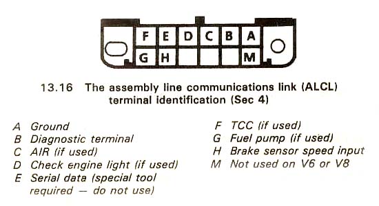

What he's saying is that: you must put the cars computer in field service mode in order to make adjustments. There should be a connector right next to your right knee when sitting in the drivers seat. That is the aldl port connector.You must run a wire from port a to b to place the computer in field service mode to make the adjustment.

Again trumped with the picture thanks tuned yet again
thanks to both of you two!!! it makes sense now...i guess it lets you adjust things and then the computer will learn to accept the change when i unjumper it. is that also where you can check eng codes? my ses light is on.....i was thinking it was because the PO took the cat off or maybe my tps sensor being bad. my rpms move around between 500 and 1500 at different times when at a red light.
