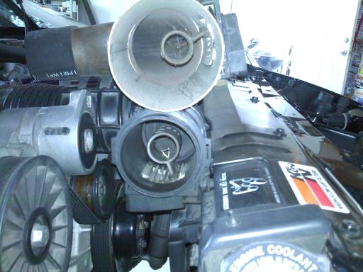

To the OP, take the 2 10mm bolts out, set the meter and bracket into place and you can see how much you need to make the holes bigger. Its been awhile but I don't think its much. Maybe it is been awhile since i played w a early car..
this is my stock 89.(ignor the other maf on top) I think dual fan cars all had the same rad support but maaybe not...

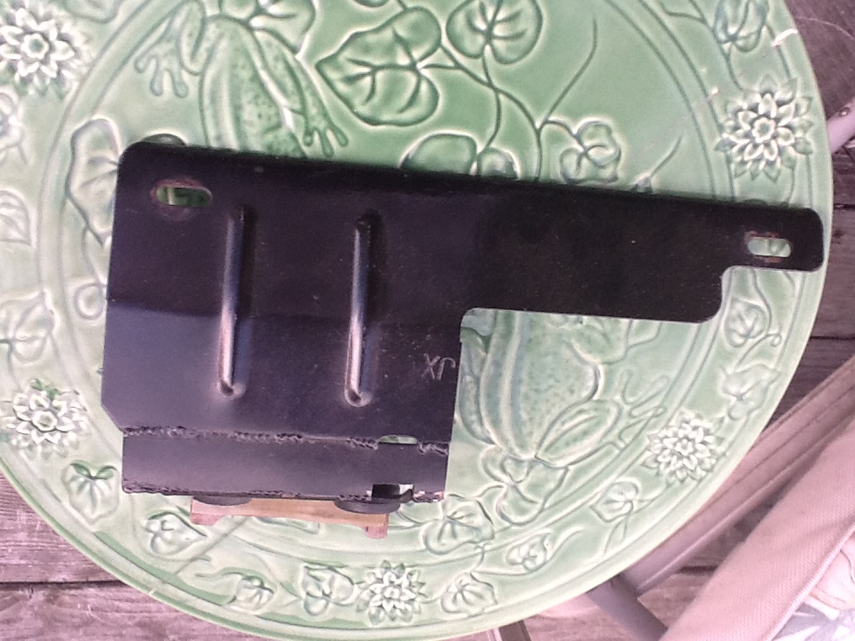

Re: MAF bracket differences ?
Here it is. I bought mine shortly after they came out. Was hoping for metal box like their prototype.
Thats nifty!
I saved the pic in my SLP file. I have seen the pix of a lot of the very early SLP stuff. I collect the pix sooo Its always nice to find a new item! thanx!
I'm going to have to find the flat part and get a pic of it.
