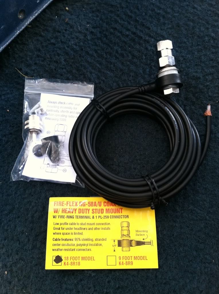

Firestik is HQ'd here in Phoenix. Stopped by the shop yesterday. Nice guy, talked my ear off, but gave some valuable info and saved a few $$ by hanging out and listening to some good stories. I went with the "Fire Ring" wire due to the tight mounting location:
As you see, the wire-to-CB end is open, allowing a smaller hole to be drilled in your truck....if needed. Kit comes with the appropiate grommet to use too.
