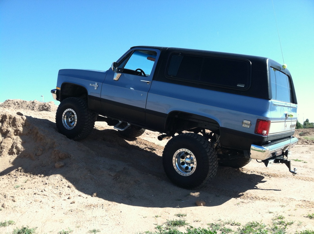

This is a Catco Cat and FM Super 44 off a Y pipe and Doug Thorley headers, 3" all the way out from collector...
Overall very happy. My impressions on the 44 is that is it deeper and raspier than the Magnaflow that was on it (model unknown, 3" I/O about 28" long). I think it is actually quieter at idle-OD too...
Had some time to kill before work...

Might have to re-think that antenna mount, lol...
