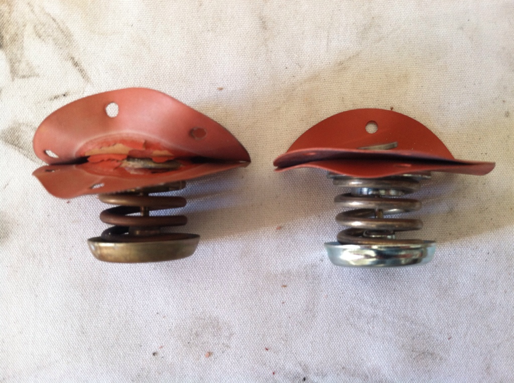

Fuel pressure regulator diaphram showed up:
Ill be getting that on tomorrow and work towards getting the plenum back on.

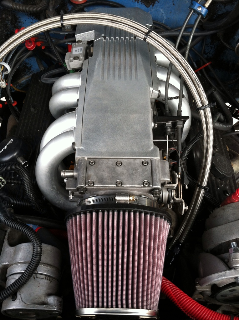

Realized yesterday that I had my runners on backwards, wasnt very happy about that!
Got them back on today, along with dizzy cap - rotor - coil - wires - plugs (#6 was a beeyotch!) - MAP - new EGR vac lines - new PCV lines - IAT and plemun:
Working on this thing is like peeling an onion. Every where I turn theres something.....
.......any good ideas to make this better?
Old Jan 20, 2013 | 10:16 PM

Got the new fittings in this AM. Was a PITA getting them hooked up to the fuel rail, but once I did I realized I couldnt route them the same way as OE. As you can see its pretty tight in there:
Being as the lines are SS I said why hide them? So I routed them like this:
Just have zip-ties on them until I can find something classy'ier. Best part about it is that I have enough line to go all the way back to the fuel filter - minimizing the connections inbetween. Starting to look like a motor again:

Your fuel lines are taking the scienic route

The only thing I can think that you can improve on the air filter is do some bends like this but towards the passenger side ending up by the rad support inlet and a open element the serp tensioner is in the way a but maybe with a tight 90 silicone elbow yo might be able to do it. I have a rubber lt1 bellows your welcome to have I can send to you and make measurement off of it if you want.

Yea, I dont mind making my own cai, its just clearing that first 120* or so bend. If I can get it behind the alt, Ill be golden.
Ultimately I think the best plan id to go to dual electric fans and just run it in front of the alt...that shroud is killing me.

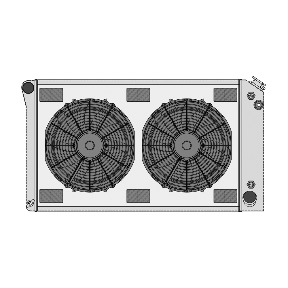

If I go dual elect, I going all in and getting a Griffin combo: new rad w/dual fans....
Better start saving some cheddar'....

You can go cheap.
Like I said before,
My 1969 c10 with a warmed over 350, I ran an ebay replacement all aluminum radiaor, $200
A 16" fan from abad71camaro on ebay $40
Thermostat Switch on at 200 off at 185 from abad71camaro on ebay $40
Kept it cool.
Swapping the same setup to my 1971 camaro.
If your current radiator is good, you can just ad the fan and switch. I am sure it will keep up.
In Fact, on my 55 belair, which has an 11:1 427 BBC I ran a Stock 1955 V8 Radiator with the same fan and a on at 180 off at 160 switch and it kept it cool! Even with 4.71 rear gears. I run a CSR electric water pump on it.
