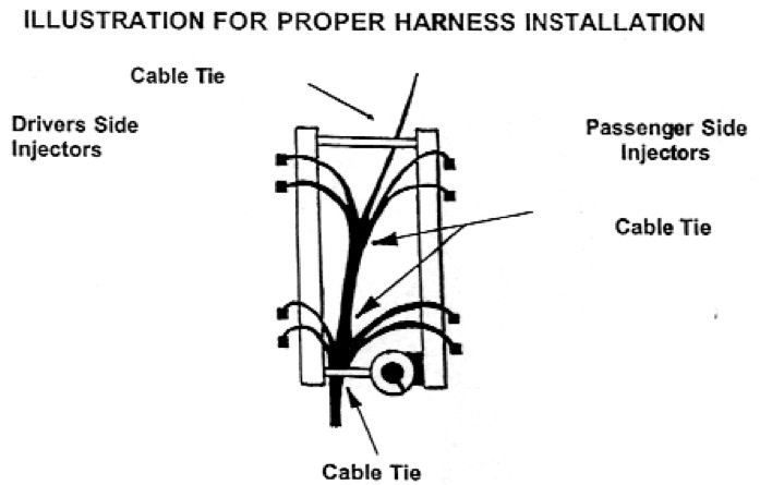

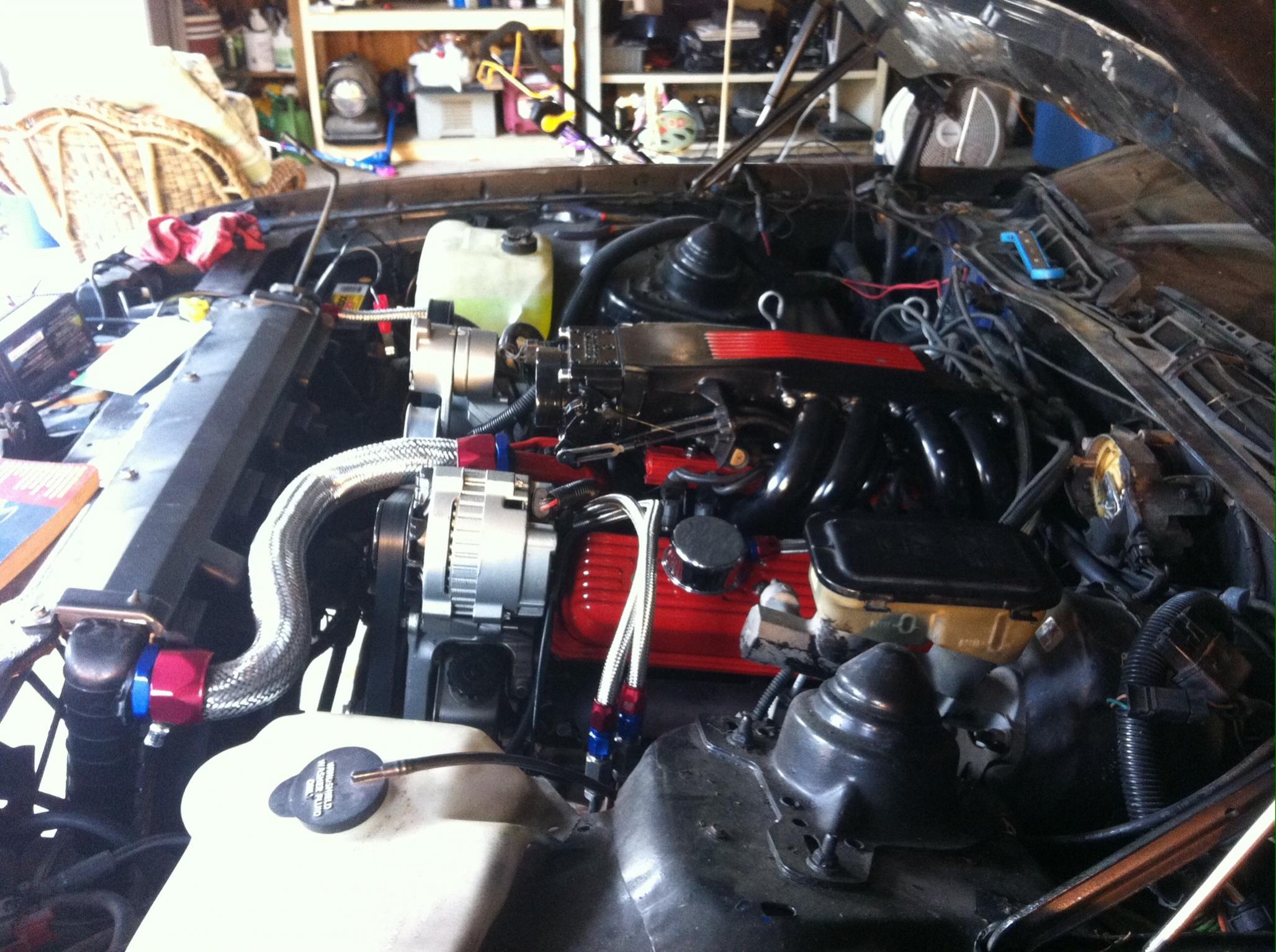

The injector connecters factory wires run along the intake between the runners and valve covers. it is a much cleaner look to run them on the inside of the intake and over the fuel rail.
