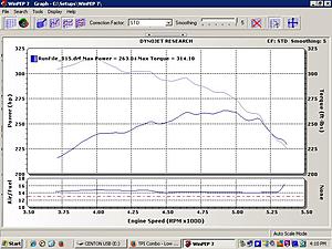

Here is the last run...

Wait......is that Sixseries dyno sheet? It lost power?
Who made 336hp361tq?

For one it looks lean but thats only gonna be worth a few ponies. Graph doesnt look all that smooth

It is very lean, it could be knocking and pulling timing which is power. Find out why it is so lean.
There was no knock, the dyno was acting up causing erratic readings.
the run before was 13.2 AFR all the way across. Same HP a little more TQ.

What was the uncorrected numbers from both runs ?
Here is the previous run...

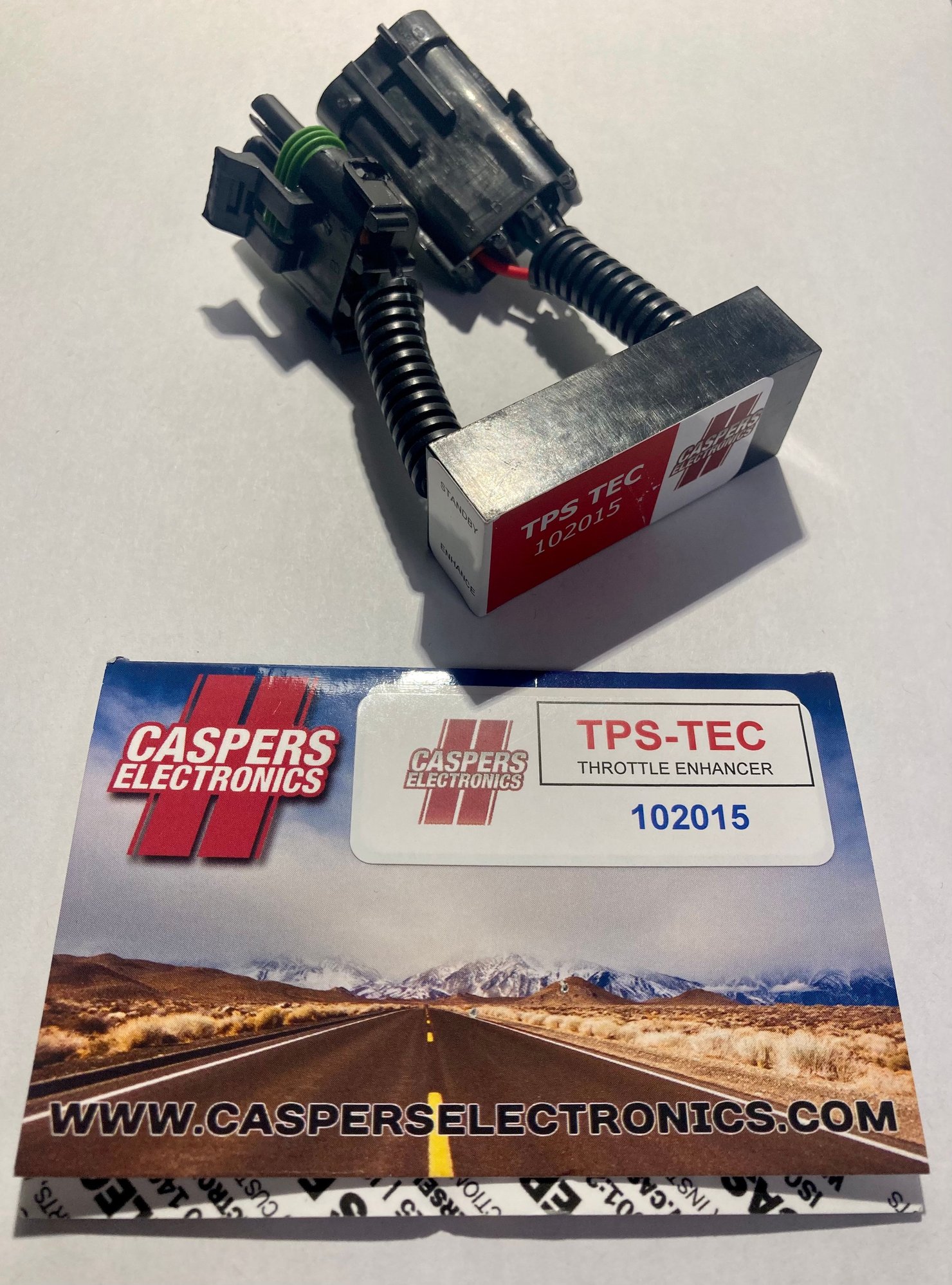

Caspers Electronics TPS Enhancer @ $116.84
102015 - TPS-TEC THROTTLE ENHANCER

Didn't know it was a thing. Never had a "slow" throttle response from a tuned port

Its not a thing, it just makes the TPS voltage the computer sees higher, so the computer thinks the throttle is open more than it really is. Supposedly that would make the computer give more fuel and timing sooner, but if you add more fuel without the incoming air to support it, you'll just be rich.
