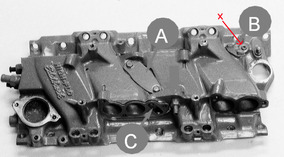

Can anyone tell me what thread this is?
Marked with X in the picture. Seems to be fine thread(UNF)
Ill have to order it from the US, since everything is metrical here....

1/8 npt

That would be 3,175mm. Its larger than that.

5/16 is 7.9375mm

Hmmm Im checking this table
http://mdmetric.com/tech/thddat19.htm
I think u were right 1/8 npt
thanks

Np, put Teflon tape or liquefied Teflon on the threads. There is a second 1/8 npt next to the pcv passage on the drivers side of the intake.

Got 2 pieces 1/8 npt on Ebay. Thanks for good info!
