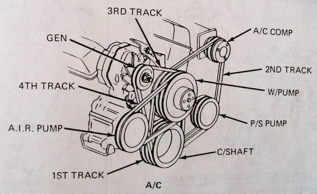

*Note - Guy in charge of drawing arrow for 3rd track should be killed, seeing as its pointing to the 2nd track belt.
Ok, well for now I have it sorted.
Plan A - Just bought a 2 groove water pump pulley which will fix this issue for now.
Plan B - In a few weeks order the ridiculously overpriced bracket from the states and upgrade the accessories at a later date
Plan C - Look into using serp belt pulleys with current accessories without tensioner.
I've seen "C" done before, just not sure what brackets would do it.
Thanks guys for the help.
Also this image helped work out I only need 2 grooves for the system if I don't have smog.
