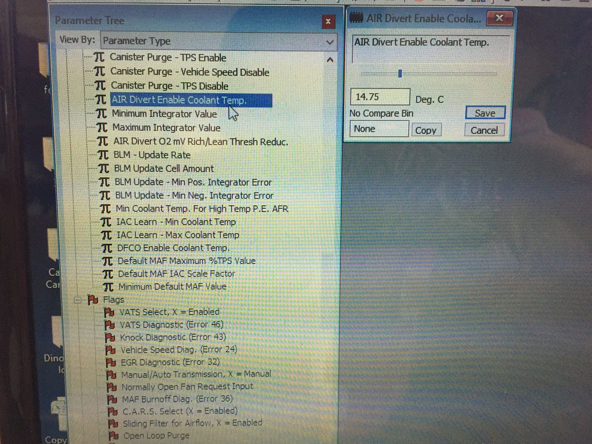

I have a 87 Monte Carlo SS with a 89 MAF 350 TPI conversion. I've been running it for about 4 years. Last week my smog pump crapped out. Was making a terrible noise. Since New Jersey no longer does emission testing on cars of my vintage, I removed the smog pump and air valves and installed a bypass pulley from TPI Parts.net. My question is; what do I need to change in the bin? I'm running the ARAP bin with 6e mask.

Set this parameter to 150* C (302* F):
LC324 FCB 73 ; 14c COOL, IF LT THRESH, DIVERT AIR
That will force the ECM to always divert the air, basically turning off the AIR functionality in the ECM.
BobR.

Another way is to enter ff at $324 in the hex editor.

Once you have your .bin loaded hit control-h .
This will bring up the hex editor.
Go to $324 type ff then save the .bin

Thank You Tuned Performance. I actually did find the hex table by stumbling around TunerPro. But wasn't sure how to find $324. How did you learn this stuff?

Tuned: Just to be sure it is where the cursor is right? Replace '40' with 'FF'?

The cursor shows the address, it's where the | is . The value on this tune star is 49 , that would need to be changed to ff .

I added air divert coolant temp to the scalars.
I have also added more flags.

Thanks for posting that file Tuned Performance. Comparing it to the standard xdf I've been using, it has several differences. I got allot to learn. You could write a book on this stuff.
