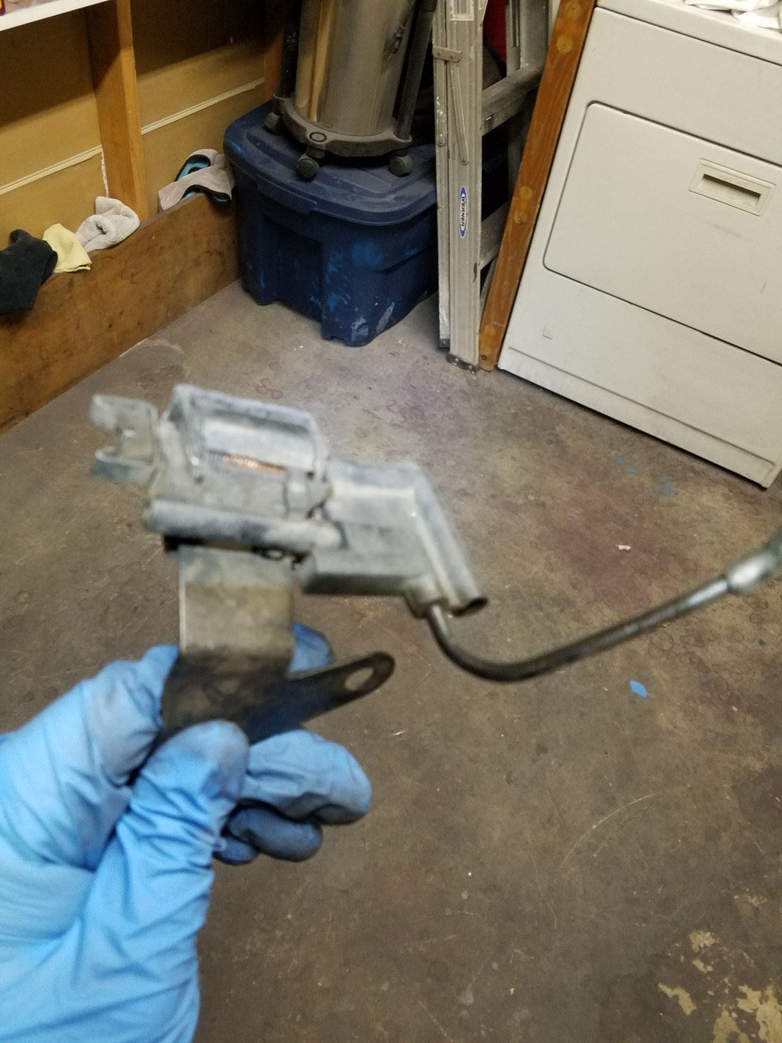

Game plan is removing the plenum and replacing the EGR valve, solenoid, and fuel regulator since I am already their and its the original 240,000 mile one, replace the manifold air temperature sensor (spontaneously received a code 25 SES), and verify all vacuum lines. Fingers crossed.

Old Oct 18, 2017 | 10:52 PM
ARAMOS3's Avatar
Joined: Oct 2006
Posts: 119
From: Downey, CA
Car: 1989 IROC-Z, 1986 IROC-Z
Engine: 350 TPI, 305 TPI
Transmission: 700R
Re: Failed CA smog please help
The EGR solenoid looks to be missing a vacuum hose.
Old Oct 18, 2017 | 11:55 PM
tealman92's Avatar
Posts: 998
Likes: 19
From: Ontario, California
Car: 1992 Z28
Engine: 383
The missing line runs to the bottom of the throttle body. So your egr wasn't getting any vacuum to work. Looks like you found the problem
