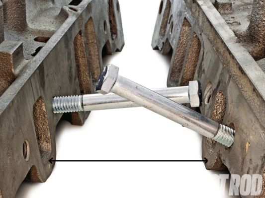

You will need to get 22#hr injectors. As well as have your computers chip (memcal) reprogrammed.
Depending on the year of the Crete motor you might need to elongate the center four intake holes.

The bolt pattern on the center four holes are different angles 72 and 90.

OH! I see. OK, thanks. Can you tell me what angle the LB9 is (or where I should find that) so I can use that when I'm shopping? If I go that route, I'll let you know on the ECM for sure.

I can recall what year 86 is . It might be 90degrees and in 87 was 72 I think.

Pretty sure the transition occurred in 87.
