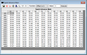

Attached are pics of the 2 changes to tables they made. Stock vs their change.
Along with the tables, they also:
Raise TCC lock low gears vehicle speed from 38 to 42
Raise TCC Unlock low gears vehicle speed from 36 to 40
Raise TCC Lock high gear vehicle speed from 38 to 42
Raise TCC unlock high gear vehicle speed from 36 to 40
Lower fan 1 disable temp from 104.74 to 73.25
Lower fan 1 enable temp from 107.75 to 80
Attached Thumbnails ECM and chip - what do we have here-stock-enrich-power-change   ECM and chip - what do we have here-hypertech-enrich-power-change   ECM and chip - what do we have here-stock-spark-advance-main.png   ECM and chip - what do we have here-hypertech-spark-advance-main.png
