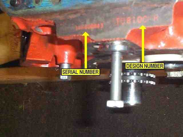

The suffix is in the front side of the engine passengers side under the cylinder head on the block. The casting number is more than likely behind the passengers side head. It may say 5.0 on the drivers side. What do you need to decode the engine block for ?

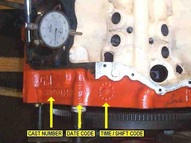

RF ledge of the deck. If it's been decked, those numbers may not be there.
You might also see casting numbers at the LR ledge behind the China wall:

Itīs very difficult to see the casting number, but like you said there is one right there on the LR behind the China wall () It's nog very easy to read that number, but maybe i can read it with a lamp and a mirror
Edit:
So far i can see there is: GM 5.0L S6I (that I could also be a T)
