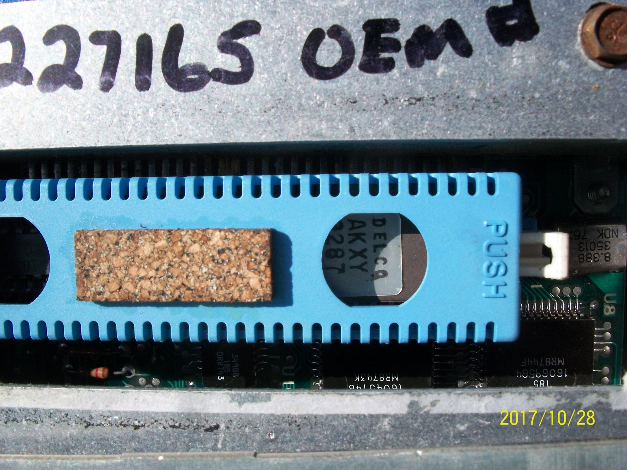

The chip swap on the 1227165 is as simple as removing the access plate (two screws) and pushing the button like it says.

Update. So i bought a new ECM...car would not start with it even though it looked the exact same and the pins fit (yes the memcal was switched into it and was plugged in the right way). It was a BlueStreak "EM7165S" and it is the only one I could get around here which is suppose to work to replace my 1227165. Anyways put the old ECM in and car had a hard time starting. Everytime I unplug the ECM out and put it back in the car has a hard time starting got to floor the pedal, but once it starts up its fine after that. But would not even try with the new ECM.
When I do unplug the ECM it idles normal until I drive and park it again then the high idle comes back like usual (1250-1500rpm in park hot or cold, 700-750 rpm normal in drive). But at least I know if I unplug the ECM a complete ECM reset happens (if you want to put it that way) and it idles ok momentarily, or at least till it relearns and starts idleing high again.
Any new ideas? Only thing I havent tried really is the EGR because of its location under the plenum, could it be stuck open causing this?? I wonder if the Innova 3140g OBd1/OBD2 scanner would work for OBD1, maybe I can try that to scan and see, Ill call innova to see if it will also scan OBD1 (I know it scans live data OBD 2)
