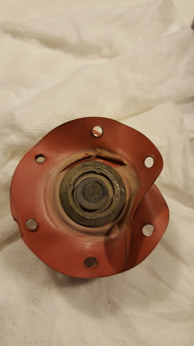

Axle/Gears: 2.77
Re: "Hydrolock" and Raw fuel smell
Definitely the fuel pressure regulator. I don't know how there wasn't a fire wow. Took off the vacuum line and directed it to a bottle. Key on and the flow of fuel in the bottle was nuts.

Lol good that you found the issue. I’ve been there before. Relatively easy fix
Old Aug 25, 2018 | 12:04 PM
IROC406's Avatar
Joined: May 2015
Posts: 109
Car: 1989 Chevy Camaro IROCZ
Engine: 355 TPI w/ EBL Flash
Axle/Gears: 2.77
Definitely easy. 30 minutes tops. Problem now is that there may be fuel sitting on closed valves. I disconnected the coil wire and cranked it and other cylinders hydro locked. Once it cranks freely I will see if it starts up and then will change the oil.

All set now
I have been driving the car for two days. Runs much better. That regulator diaphragm must have been leaking fuel for quite a while because I had to hold that throttle a bit in order to start it after a period of time sitting. Now I can start it with no throttle assist. So, I did a new VE LEARN last night and what a difference. New found torque everywhere.especially when I am on the highway.
