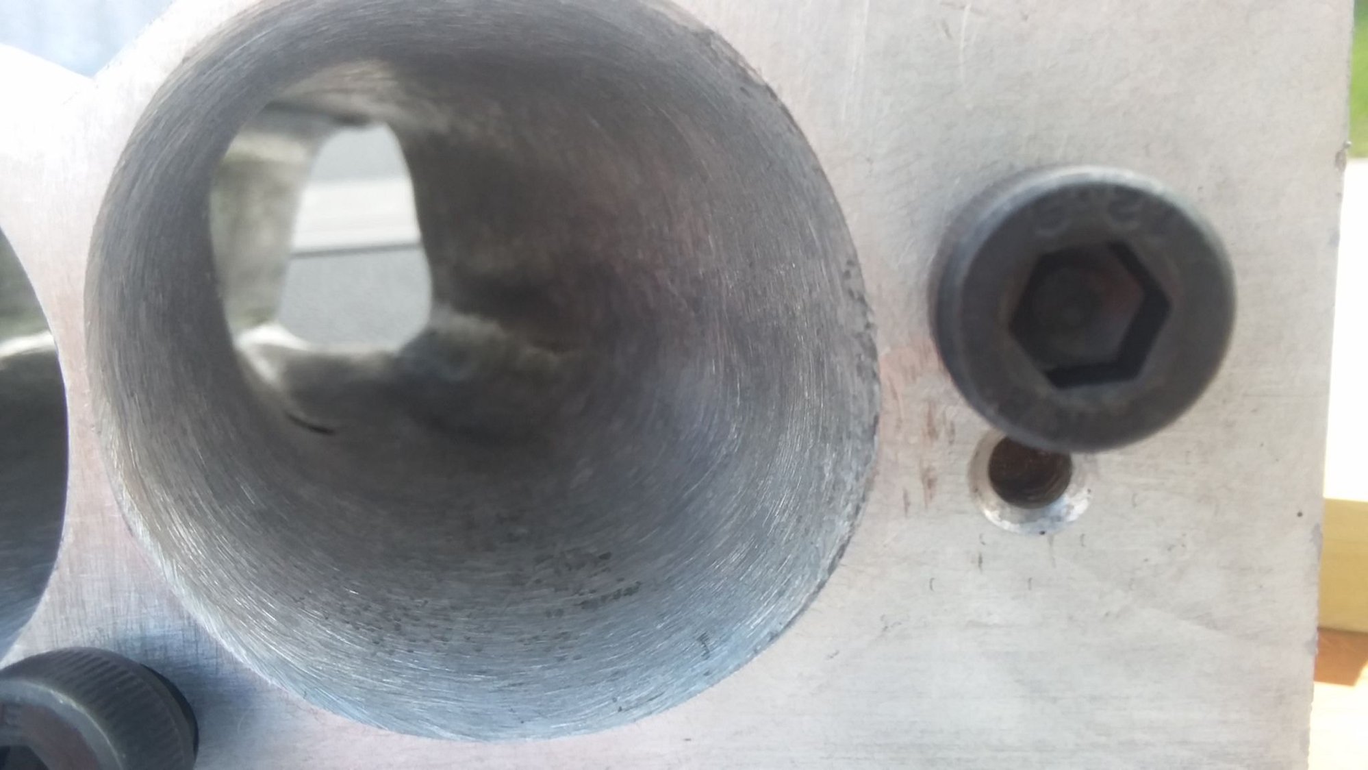

I was at HF yesterday and standing in the checkout line I found a digital inner and outer micrometer. Yes I know it it a Pittsburgh product but for what I am doing it will be just fine. I would not want to trust it on a crank journal but it sure works sooo much better than the tape measure I have been using. It was a whopping $10 I am trying to maintain some consistency on the port openings and this $10 well spent mic will do just the trick. All the openings are within .01 of each other. I guess the tape measure worked o.k.
Here is the new opening size.

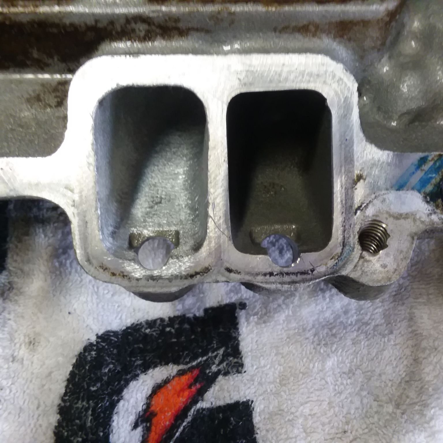

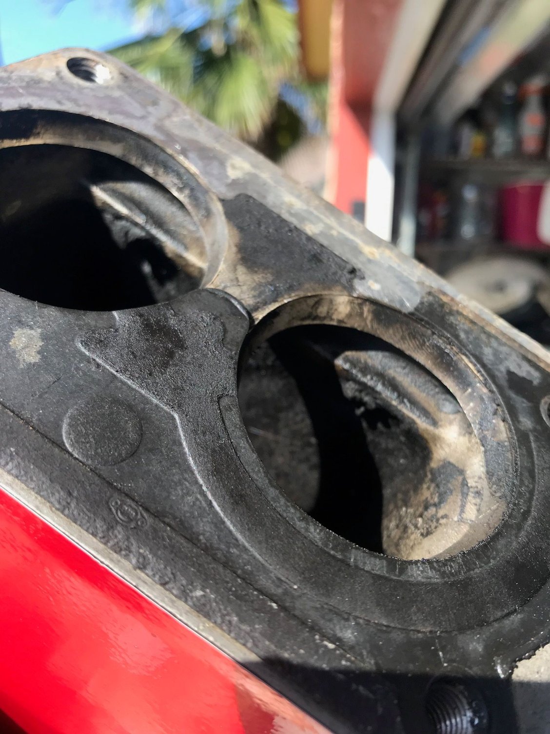

I had today off so I was able to make some progress. I work tomorrow and that should be it for my weekend work! At least for now.
I got one side fully complete. I had some finished prior but I put a good 3 hrs and finished 4 ports all the way through. I think I am going to have about 8-9 hrs total in the one side. It is going good, being careful not to cut to much and have not gone through anywhere! When you look down the ports it really looks like it is going to flow really well. I wish I had access to a flow bench. By no means is it perfect but it is leaps and bounds above what the untouched side looks like. I am not definitively not a pro at this but thus far I am satisfied with how it is turning out.
Those cutters I bought do not disappoint. I may not be making the ports as large as possible but it sure is removing material!

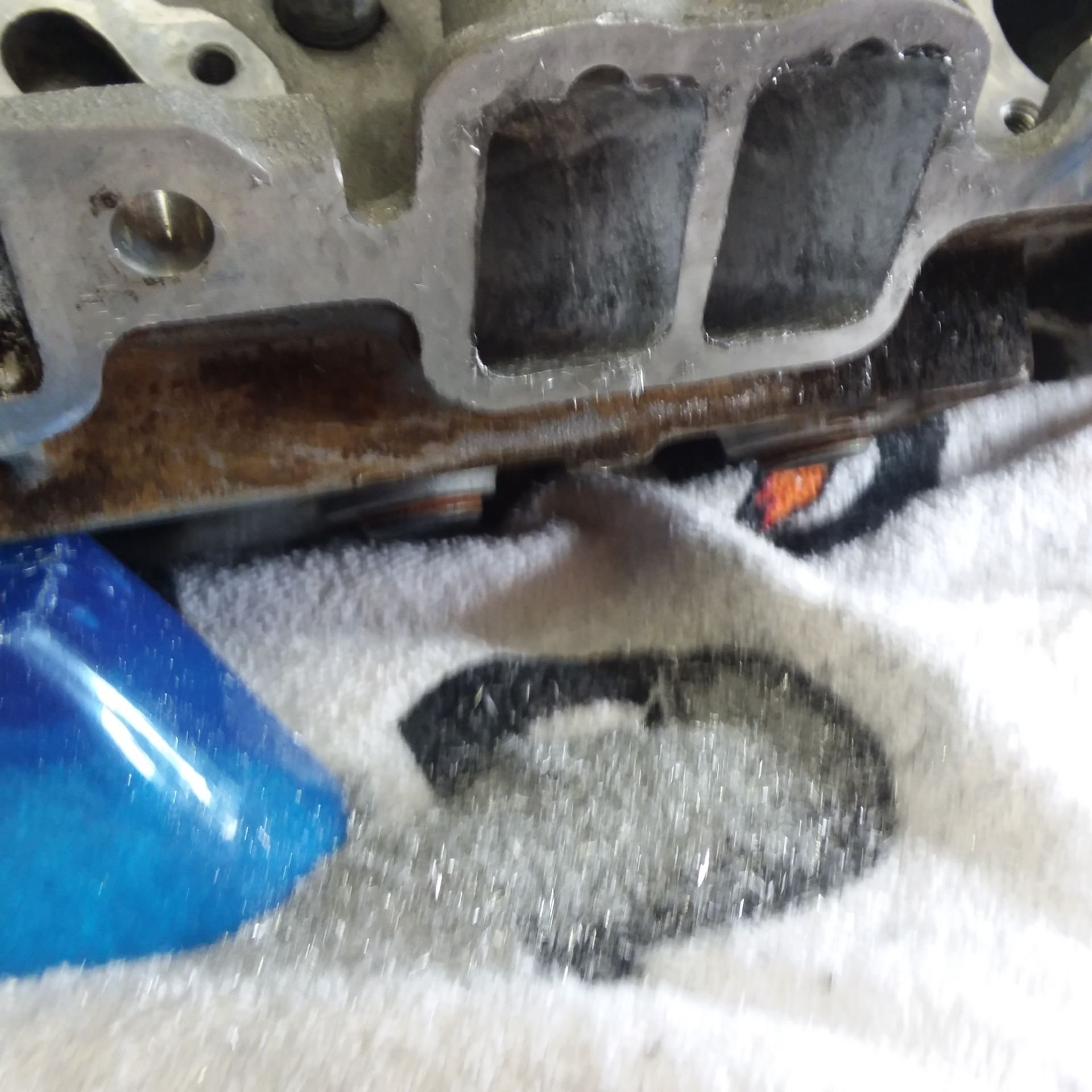

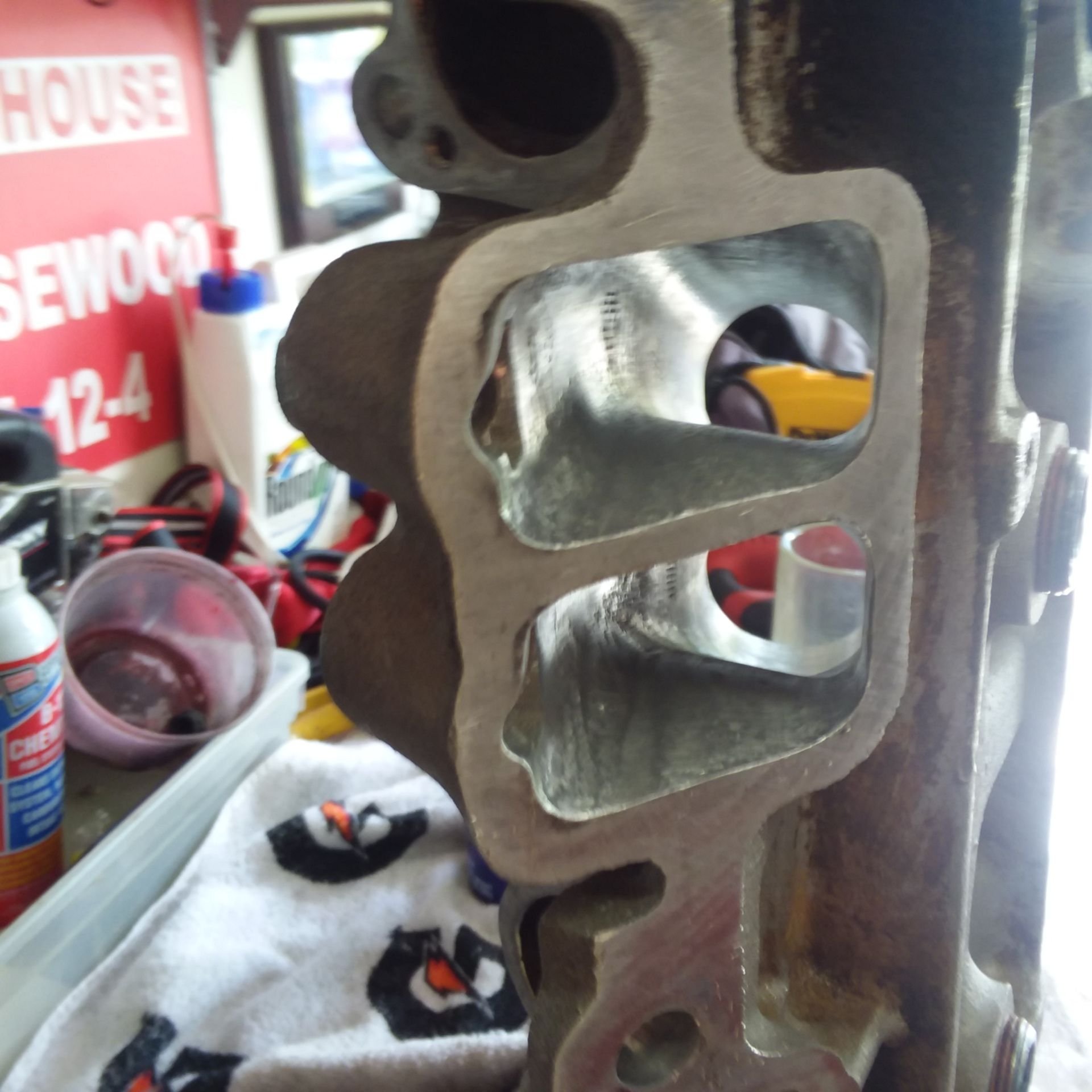

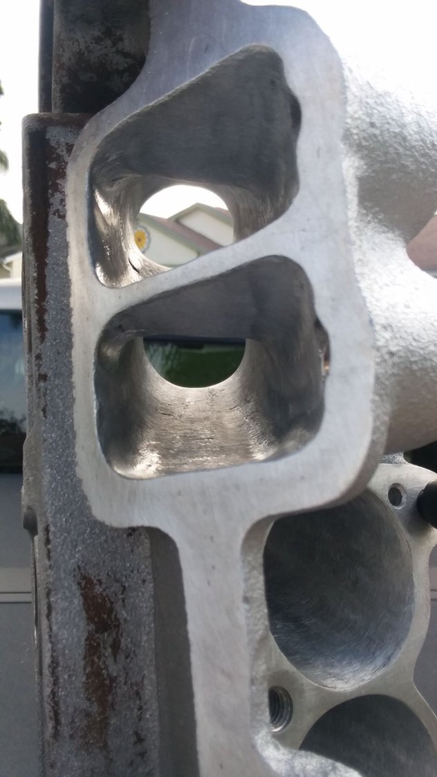

Here are some pics from both sides where you can see through. It is hard to get a goot pic looking through.
That is not a crack, although it sure looks it. It is a small shadow fron the casting mark in the runner. I took the pic after I washed it off and the water makes it look like a crack.

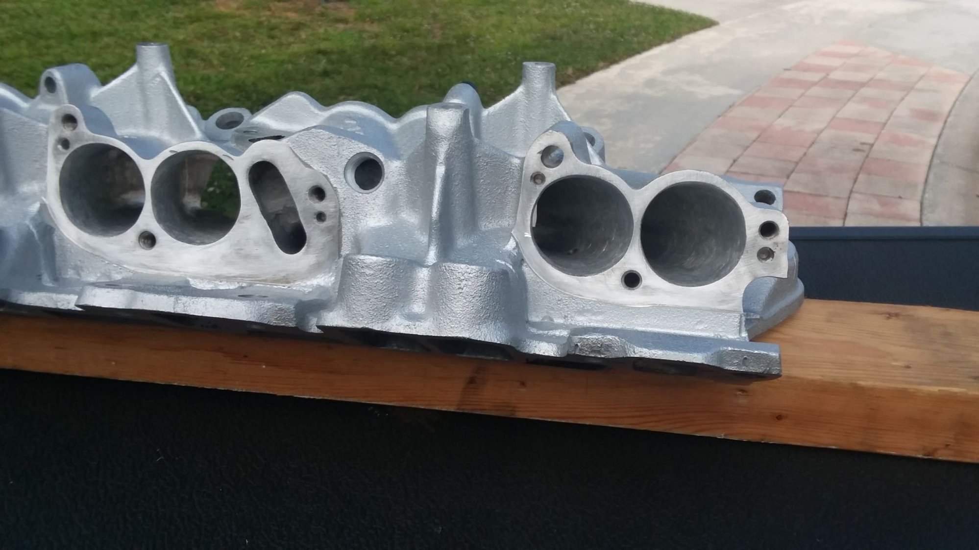

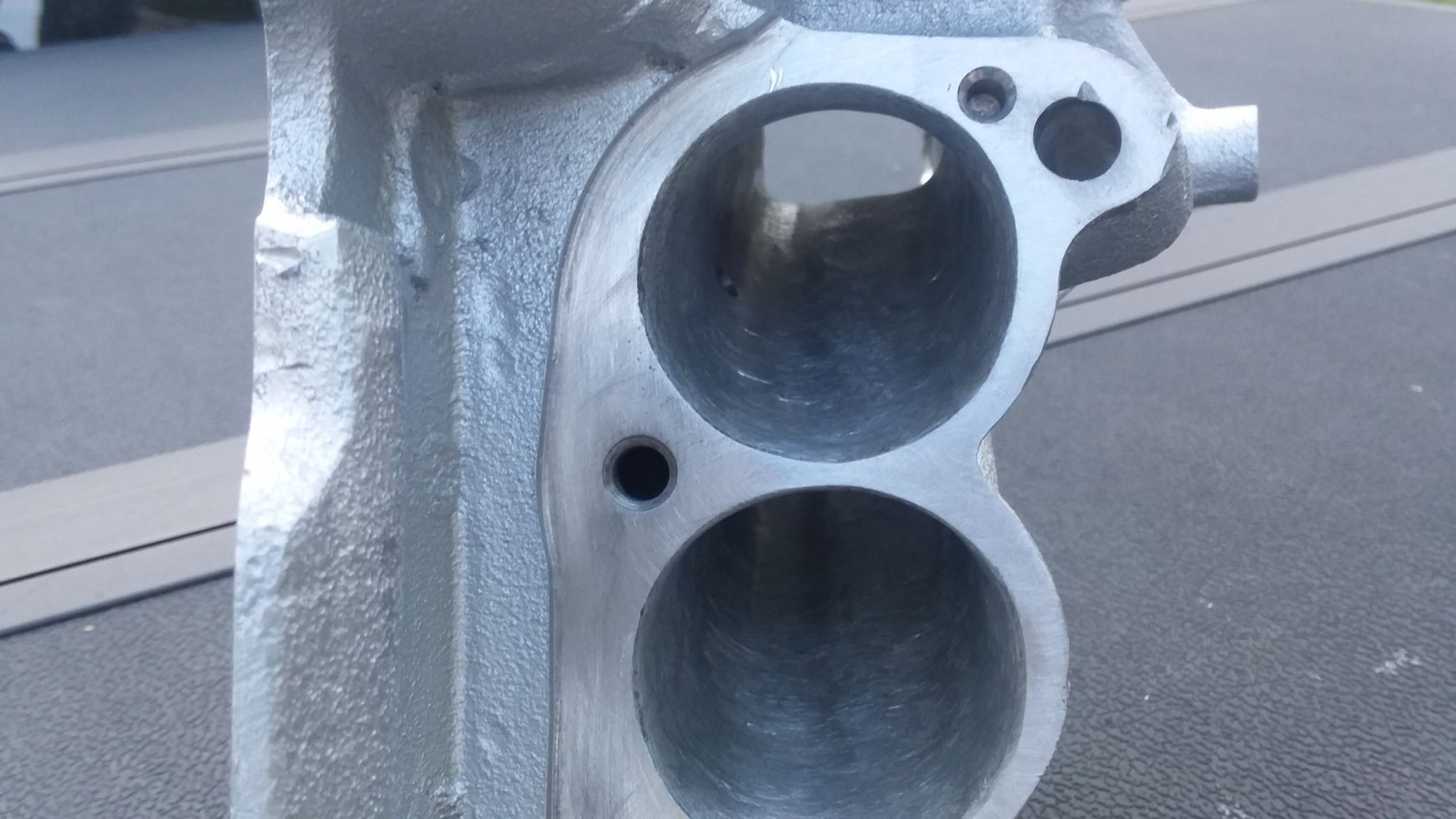

Alright, I am finished with the port work. It was a lot of fun and learning but by about the 6th port I was getting to where I wanted it done. I walked away from it for about a week and then got my second wind and finished it up! I got about 20 hrs in it and have no regrets that I did not just buy one. This was a learning project for me. I was able to see first hand where the restrictions are in this system, and work my porting accordingly. I took the advice given to me by the OP's in this thread and took that info and ran with it. I hope you all will like the outcome of my work.
Old Mar 31, 2019 | 07:27 AM
  #76
vinny R's Avatar
Joined: May 2015
Posts: 1,765
Likes: 286
From: Florida
Car: 1991 Z28
Axle/Gears: 3:42 Auburn
Re: My TPI Breathe Build
There was a major restriction on the left side of each pot inlet, the runner side. It stuck out at least 1/8" or better. You can see it in the before pics in this thread. I really went after this side and pretty much removed it all. I only opened up the right side slightly, enough to get the casting marks out. The metal gets thin as you go down the port so I was careful not to remove to much from that side. You can still see a remnant of the casting mark as I was afraid to remove to much material. I used one of those magnetic bolt retrievers and tapped on the walls to get an idea if it was a thick area or not.
On the other side I was able to really smooth out and remove a decent amount of material from the right side. This side looks thick but when I tapped on it it did not sound that thick so I was careful. The bottom of the wall on this side was rounded at the bottom so I took out a decent amount in this area which in turn made that side larger The left side I opened up quite a bit. I was able to smooth out the bend on the left side and make the port width larger. When I look down the port I can really see where It is a much straighter shot for the air to flow.

I have an update to my project. For those of you who are still following this I did say in my first post that this could take awhile, well it is!
The car is in the shop. I dropped it off Friday morning and will pick it up Monday afternoon. I took tomorrow off, I have to drop off the remaining parts I cleaned up and told Jason I would run around if needed for any parts I may have forgotten. I went by his shop Friday afternoon to pick up my TB, fuel rail and bolts. I also picked up one of my valve covers which needed some JB welding. He had it all torn down Friday and I was quite pleased with what I saw under the manifold. I was afraid it might have been a sludge motor but that is not the case. Yeah! I will take a pic Monday morning before he starts putting it back together. Today I will finish Ceremic Coating the rest of the parts before I bring them tomorrow. I have done this to all the parts prior to putting the on. I hope this will allow me to just wipe clean the engine with a microfiber dusting wand..
These are the rest of the parts I cleaned up. The fuel rail I polished first. I painted the fuel lines only. They were already painted as I could tell my manifold had been removed by one of the 7 PO's. I then cut red vinyl 1/8" strips and layed them on the raised part of the polished rail. I like the look of the new Delphi Injectors, the chrome and black fit my decor. I was going to polish the TB but in looking at it what a PITA that would be. So I just cleaned it up so it has a new look and used some metal polish with a brush to get in all those tight areas. I painted the TB plate and will sand off the Rustoleum Sunrise Red paint on the raised TPI lettering. I used Rustoleum 2x paint and primer satin black on the bolts. It sticks great and gives a really nice look when everything is assembled
I started this to get some performance from my air starved TPI, but I also knew this was a great opportunity for me to clean, paint and replace some parts that bothered me by the way they looked.

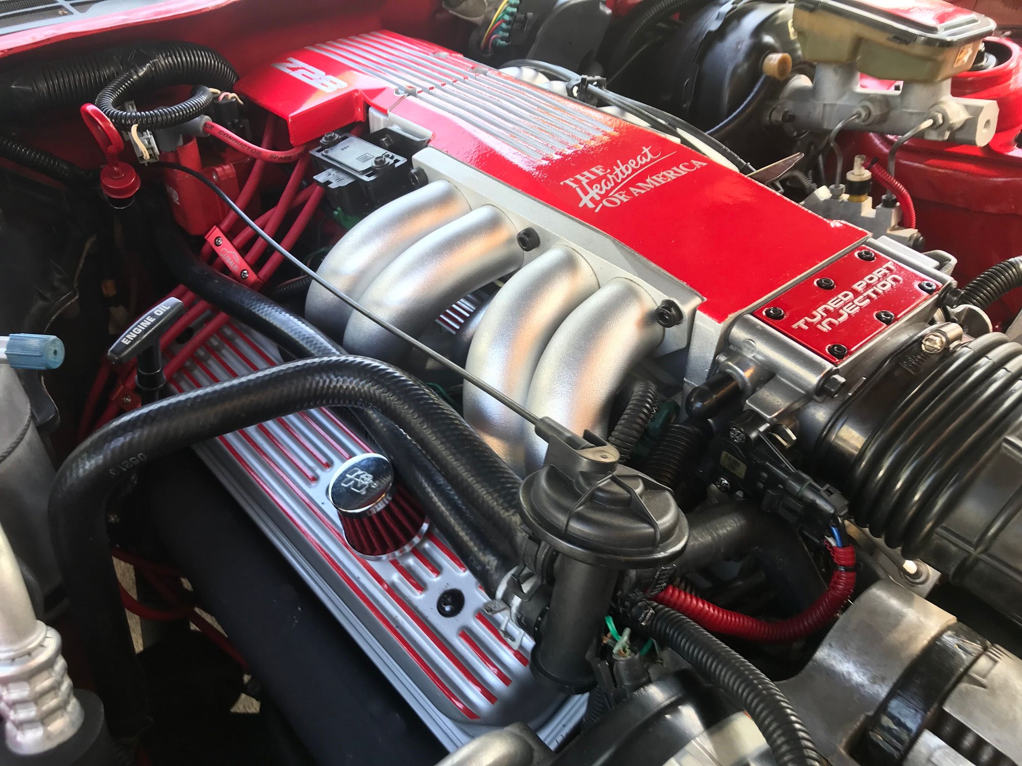

Here is a pic of the finished TB and fuel rail.
I am really excited and can't wait until tomorrow afternoon. I really hope this runs good and these improvements make a difference. I think it should!

I wanted to share this with you guys also. Look at those small "volcanos" forming on the wall in the plenum!. My large holes behind that wall are completely closed up! The exhaust gas has created these so it can push it out from the closed passages. Anyone ever seen this before?
It is those small piles that look like poop an the top of the wall, Iit was hard to get a good pick.
