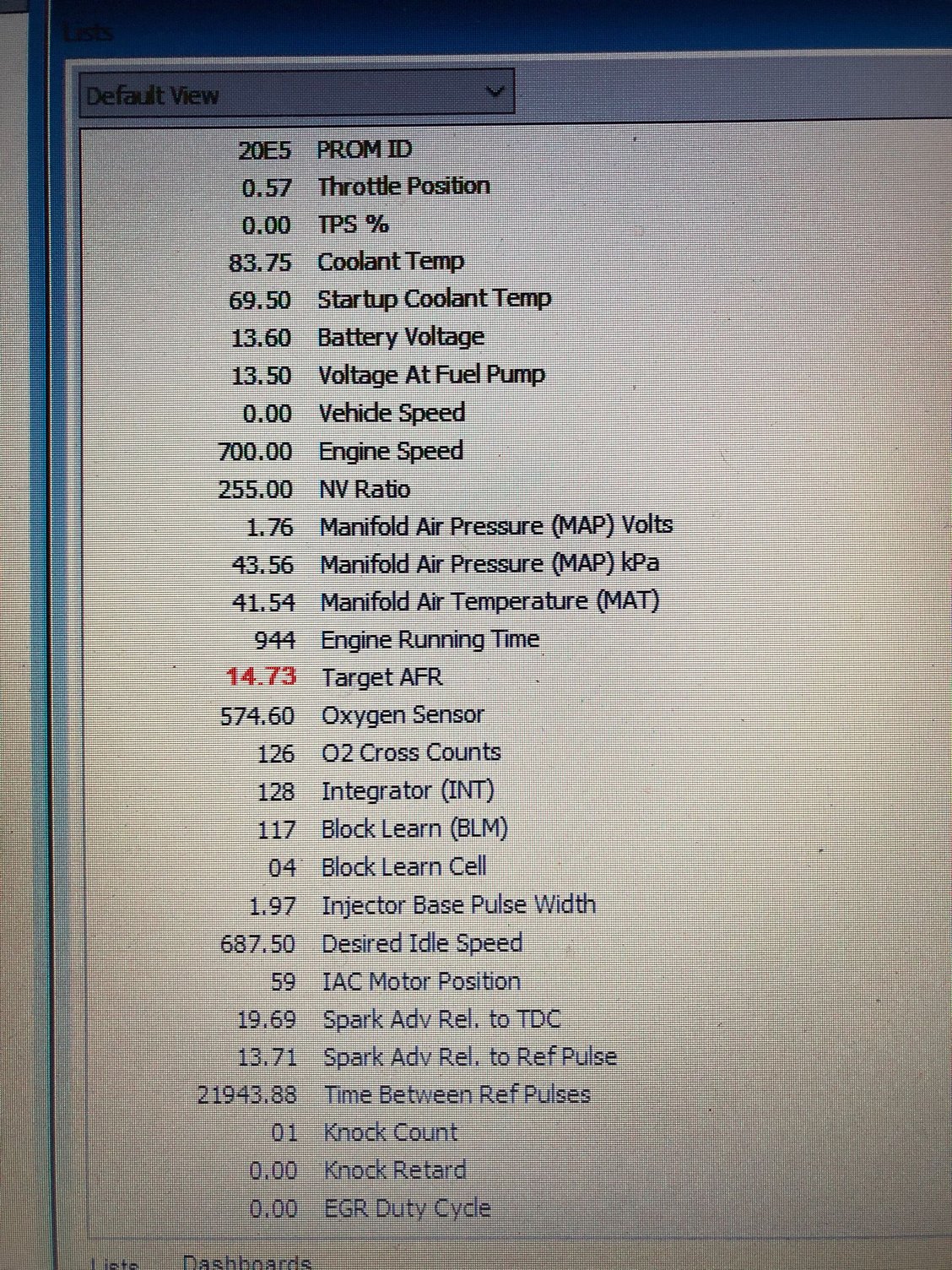

Thanks for the tip 355! I'll give that a try

Originally Posted by Fast355
Adjust your TPS voltage to be about 0.5-0.6 volts at closed throttle. It has fixed a few off-idle stubles on cars I have messed with. Also verify the timing is 6* on a stock engine. You can experiment up to about 10*.
Thanks Fast I will also, I know my timing we set just above stock @ 8'

Originally Posted by Pet_ROC
Very nice work, looks great! Sounds like the gains were well worth it. I actually just installed AS&M runners and new injectors on my car too. Already had a ported base & plenum installed but was running stock runners. The tune should improve your set up also. I just took my car out for the first time to datalog and it is now lean from 2000 rpm up. Working on my tune now. Learning TunerPro is not too bad with all the info on this forum.
Were you able to correct the off idle stumble you described with a tune?
I did almost exactly what you have done to your car and have the same off idle stumble. I have all the cables and software and hardware for tuning-just a general lack of knowledge on my part on the subject.
I agree with the improved power. Mine pulls pretty hard to 5500 rpm and gives a good seat of the pants feel where before it was maybe a little sluggish. I've been driving the pee pee out of it and now that the weather is cool, the T Tops are coming off!
What do you guys have for exhaust? I still have the factory L03 exhaust. This is the "Low Output" 3 system with under 2" outlet manifolds, that great flowing "T" pipe, and a whopping 2.25" primary pipe. It may have an aftermarket muffler as it sounds really droned and I can see where it was welded in. Someone could have changed the FP at some point so they may have had to cut the muffler out. This has to really be choking me down especially after the breathing intake. I am also wondering if this has something to do with the hesitation. My car is in the shop so I have not tried the trick Fast 355 suggested.
It is in the shop for this, complete new system from the heads back. These are the L69 performance manifolds, 2,25" outlets. Next is a Magna flow 16450 Y-pipe, 2.25" primary pipes into a 3" pipe. I will have a 3" test tube made by the shop to take the space of the Cat. Next is a 3" Hooker Super Competition cat back system with the Aero Chamber muffler. 2.5" dual tail pipes with modern looking dual outlet polished stainless tips.
As stated in my original post I am trying to stay with the stock look on the engine so that is the reason for using manifolds. I also stated I would be OK with leaving a few ponies on the table because of this. I also said I would go through the exhaust but at the time of the post I was not sure what that would look like...well now I know!

Hey Vinny, when you get a chance go over to Paul at prime tune and have them check that your TPS voltage to be about 0.5-0.6 volts at closed throttle as Fast355 suggested. Mine was around .45 V and bringing it into spec range really improved drivability.

90-92 tps spec is .67-76 and is self zeroing.
I forget the 90-92 was spec'd higher and from what I remember non-adjustable.
My response was specifically to the MAF TPI I responded to.
My TPI was an earlier system with an adjustable TPS. I had the TPS Voltage set to the higher end of the TBI spec to match the 95 TBI PCM I was running it with.
Thanks Guys. I did notice the last TPS I installed really did not have much of an oblong hole for adjusting. The other thing I noticed after I set the IAC that if I did move the TPS a ltlle amount, it did seem not change anything.

I am finally getting my tune...yeah! I finally got Tuner Pro RT to work. It was my old laptop that was the problem. I got a new windows 10 laptop, Loaded Tuner Pro RT. I bought a Moates Extreme ALDL cable with the 10K switch. I did the pre settings in Tuner Pro, just looked at a couple youtube vids to make sure the right boxes where checked. Plugged in the cable and windows 10 downloaded the drivers for it. Went to the acquisition box in tuner pro, did the cable check and all was good. I went through a lot of troubles before with this and turns out I just needed a new computer. Now I just plug everything up, cable to the car and the computer, start up tuner pro, turn on the car and hit initiate in TP and she instantly connects and stays connected when driving. No witchcraft involved! I have not figured out how to make the custom dashboard but I must say it is pretty cool seeing the data list in real time. This was my initial run with the aftermarket hyperteck chip.
Old Jan 19, 2020 | 08:29 AM
  #131

I am working with Brian @ Tuned Performance for writing my bin file for the chip burning. He rented me a chip burner and I purchased 2 chips and he sends me the bin file over the internet and I program the chip. This is working great as we don't ship back and forth.
He sent 2 files, and I have the stock chip plus the Hyperteck. I will say that the tune is a must when doing a mod like this I you REALLY can feel, hear and smell the difference between chips. The hypertek chip was actually hurting me as it was too rich and that I believe was the cause of the hesitation. I put the stock chip back in and the hesitation was gone, but the car really fell flat in the upper RPM. My exhaust sounded different when switching the chip. Next I ran the Chip 1 and it was much better than stock, and more refined than the HT. Still some hesitation with this tune and a little slow on throttle response but good pull at the top end. Finally chip 2. This one worked the best, no more hesitation and rich smell. The car starts up quick. The exhaust sounds "cleaner" and with the HT chip there was a weird exhaust note coming from the Y-pipe, almost sounded like a leak. The off idle transition is now smooth and so is the mid range acceleration. It may suffer slightly @ WOT. Brian has refined chip 2 for smoother fueling which I will burn that bin and try it later today. After trying the 4 chips I will reiterate and say that this is a MUST when changing anything that has to do with fuel/air ratios. I thought the car ran good on the HT chip and I was mistaken!
I will post up my info from chip 3 but from what Brian said chip 2 looked good on the data end, one thing I noticed in looking at the list data in TP when I got back from the run was my BLM and INT where right on the money @ 128 with chip 2

Yeah Tootie, what a difference the right tune made. #2 ended up doing the trick. We refined #2, Brian said it was "spiked" so he smoothed it out. The computer numbers looked good but the car did not like it. It did not run as good as the "spiked" tune. The burner is the way to go, it made the process sooo much easier. I also had ZIF sockets Brian loaned me, basically a quick release for the chip, lift a lever and remove and install the chip. Brian would e-mail me a BIN, I would burn the new file, install the chip, do a dta run and send him back the recorded XDF and he would make the adjustment and e-mail the new BIN. If you are keeping the TPI on your 350 build you may want to see if your tuner will work this way, I know you went through 7 or so tunes the 1st time. It was pretty easy or as easy as this system could be. I did not take a pick of the data list but all the numbers seemed to be right on. Both the BLM and the INT were right on 128.
The car runs and performs like it should. Hesitation is completely gone and the throttle is smooth through acceleration. Starts up quick at all engine temps. It pulls through all rpms and seems to go to 5500 before it falls off. Exhaust comes to life @ about 3500 and has a reel seat of your pants kick when the trans downshifts and the revs go up. Did lose a little of that low end "grunt" but the gains in the rest of the RPMs are well worth the trade off. Has not lost a thing in the burnout dept, in fact I can roast the tires for a longer distance now .
I feel the tune is a must when you are doing this mod. When I ran on the stock chip I really did not feel all the extra power @ the higher rpms. kinda like it was chocking it out or running it lean. The HT tune was rich and was not smooth or driveable until you hit about 4K. I feel that all this work was well worth the time and $$ as the outcome is awesome. This made a HUGE difference in my car, it was always fun to drive but now it is a BLAST to drive and now I can hang with those performance mini vans and hopefully outrun those Ford Fiesta performance cars!
If you are still following this Brian I just want to give you a big for all you did to get me tuned up!

Hey Vinny , thanks for the shout out. Glad it only took two tries to get your tune right.
it can take multiple tunes sometimes and with tpi maf for example there are some bugs with the maf tables and sometimes you end up with corrupt tunes.
having a burner on hand is way easier than shipping chips.
glad your runner upgrade and porting job was such a success.
now if we can get your buddies car tunes your have to do another race
