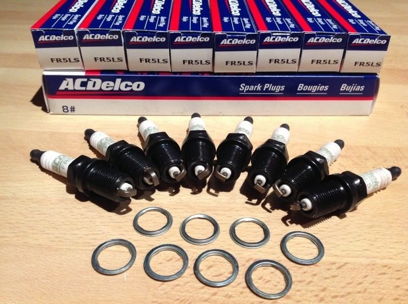

What spark plugs do you recomend getting

R45ts
This is the plug for the Iron Head L98 as Tuned Stated
This is the plug for the Aluminum L98 Heads with angled plugs. I believe the ZZ motors came with aluminum heads. Which would make these the correct plugs.
