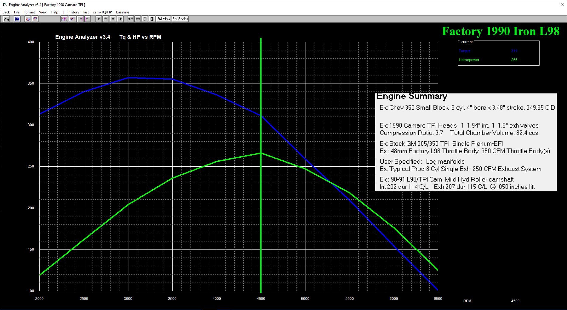

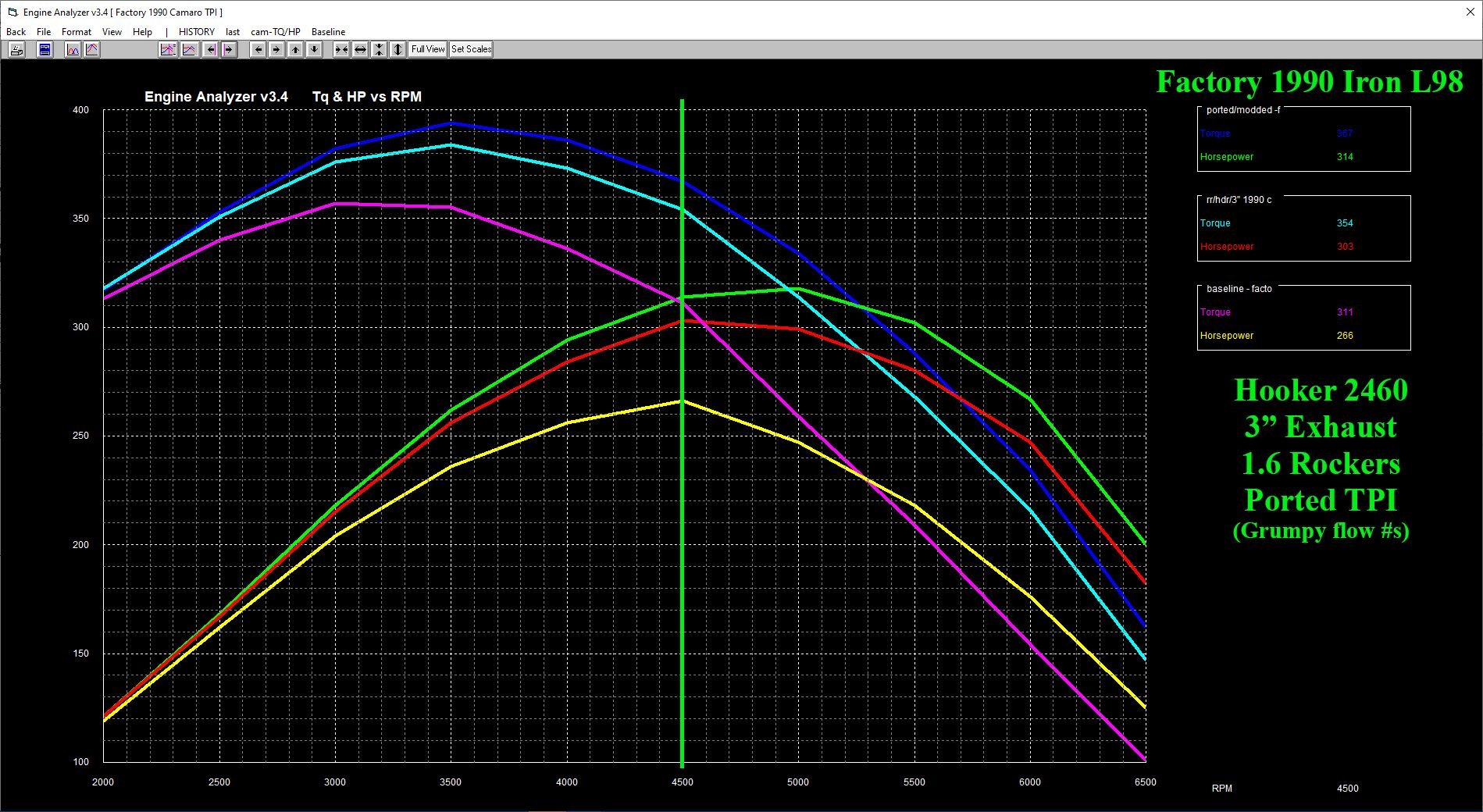

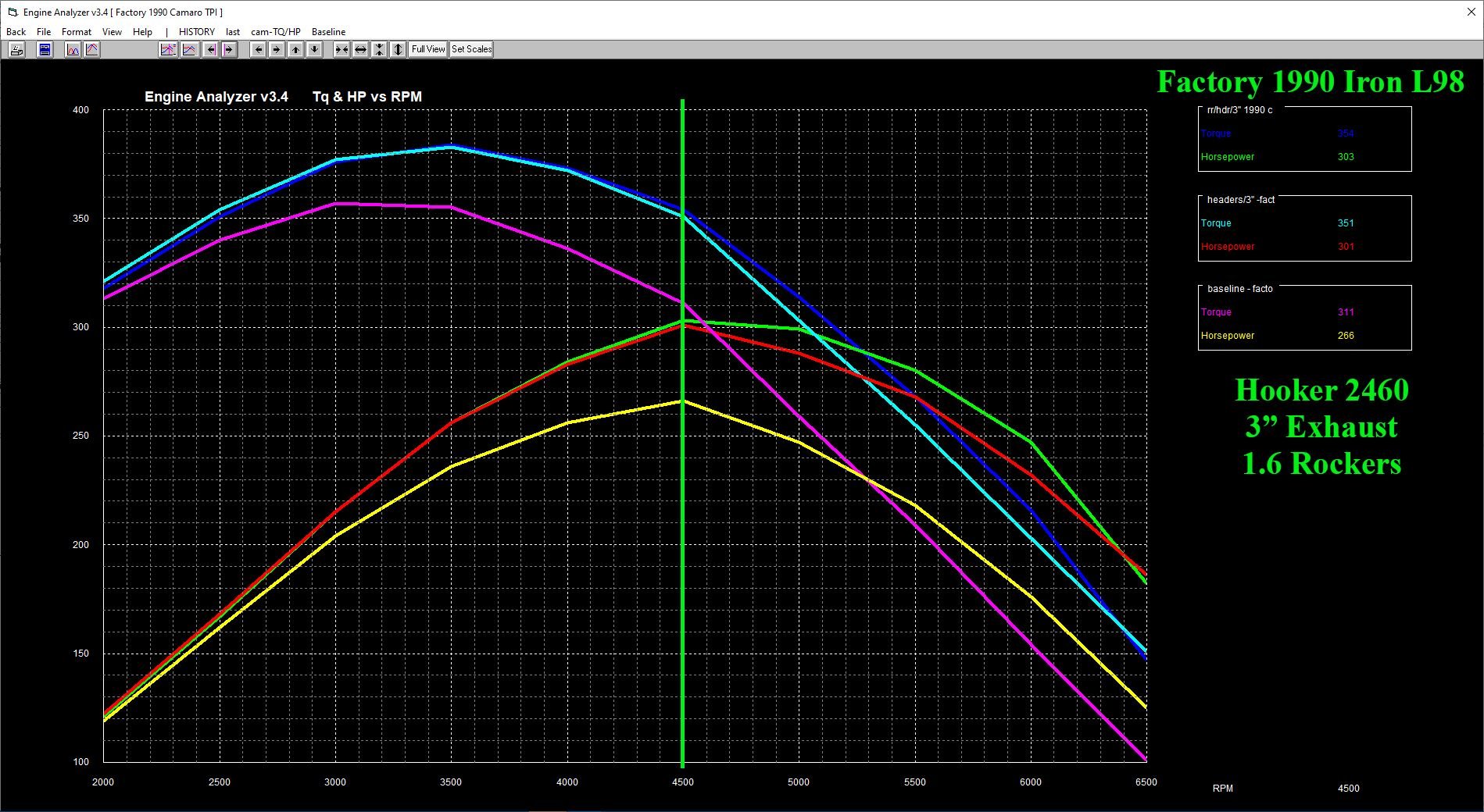

Spent the vast majority of this morning plotting out engine builds.
