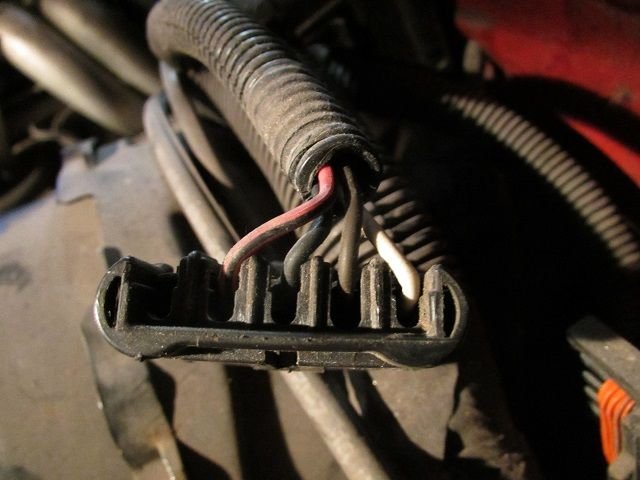

I located the ESC and the resistance at the white wire (schematic from Chiltons) to ground is 150k. Is this to high or is this acceptable?

Re: Code 42 problem
Seems alittle high, but since you are not battling a code 43 and the code isn’t throwing during forced knock test. You should be fine and should focus on the error 42.
