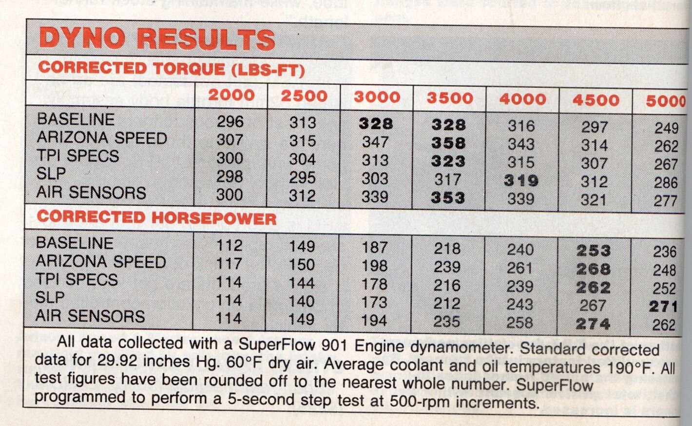

Well here is what I am trying to, and what I think I will get:
In Car Craft’s May 1989 issue in their article TPI Shown Down: they tested a 1998 Corvette L96 with its aluminum heads, stock but for Edelbrock’s 6873 IROC Tubular Exhaust system running through a stock 88 Cat for the testing. This made 253HP 4500RPMs and 328 lbs-ft at 3000 to 3500 RPMs.
The tested on Edelbrock’s Superflow 901 Dyno, which was able to pull numbers every 5 seconds and at each 500RPMs from 2000 to 5000.
So this base line engine did the following:
Torque:
RPMs torque
2000 296
2500 313
3000 328
3500 328
4000 316
That was only a gain of 32 Ft-Lbs from 2000 to 3000, the torque peek.
The stock specs for that car engine was:
Horsepower 245 net @ 4300 RPM
Torque 340 lb. – ft. @ 3200 RPM

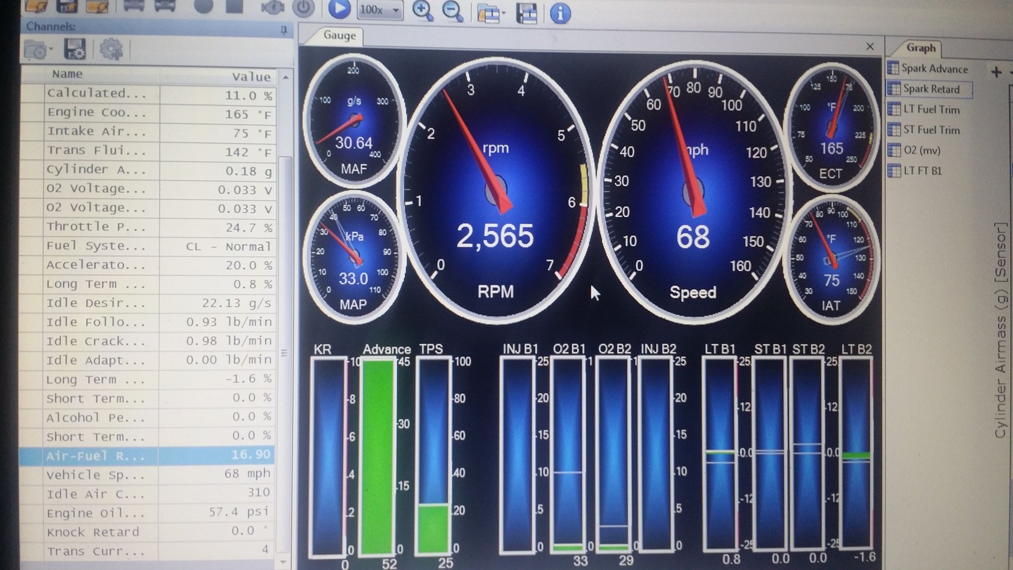

Car: 1983 G20 Chevy
Transmission: 4L60
Re: Lowering the power curve of the TPI
When I went through Kentucky a few years ago I had the 4L85E and 3.73 rear. My 350 with the 395' cam, marine intake, thorley tri-ys, and a 91 octane tune making alot more torque than stock had a very hard time maintaining speed on hills locked up in OD. The 350 was giving it all it had to keep the empty van up to speed.

Its not even a debate it is simple fact. If you want good MPG out of a heavy vehicle with the aerodynamics of a brick it needs to be geared to to make adequate HP for the load it is pulling at highway speeds. 2,000 rpm @ 70 mph is too low for a small block to get good fuel mileage.
My Hemi Ram with a cam that had huge low-end torque gains got better MPG with 4.56s than it did with 3.55s.
This is climbing a similar grade in the 4.56 geared Ram. Ram did not even struggle to accelerate in high gear up the grade.
I am out anyway because some people need some physics lessons in this post. RPM alone does not dictate fuel mileage. Engine load plays a huge factor in it. Lugged engines get **** poor fuel mileage in my experience.

I lost 1 mpg increasing the cruise RPM of a modern Hemi engine from 2,200ish to 3,500 rpm. I would say that the friction difference was not as drastic as you state.
Wait...WHUT!!? Didn't you say above that you got better mileage at a higher RPM?? :bigears:
Will also tell you their is a huge difference between towing a little boat behind your little truck and towing a 6,000 lbs travel trailer that is 11' tall and 8' wide behind a fullsize Express van. Huge weight and frontal area difference. I would place a bet his high top G20 van has higher engine load because of the aerodynamics at highway speeds than your truck pulling your boat.[/QUOTE]
1. What do you know about my boat?
2. My "little truck" very likely weighs more than your "little van". ....although it doesn't matter for the purpose of the discussion; they're BOTH anecdotal, "tall tale", worthless stories and examples. :yesnod:
Originally Posted by Fast355
Funny you say that bit with the scan tool. You are correct with an unloaded engine. However on the real world running 70 mph my MAP, MAF and IPW were all drastically lower running in 3rd gear than OD
So...that's it then, right? THINK. Do you suppose the injector is firing more pulses per unit of time, at the higher RPM? Hmmmm.....

So...that's it then, right? THINK. Do you suppose the injector is firing more pulses per unit of time, at the higher RPM? Hmmmm..... [/QUOTE]
My Express van has gone over the scales at 6,400 lbs with a full tank and me in it. The full conversion package with rear a/c, power sofa bed, lots of wood and electronic gizmos as well as that 10.5" rear, 1 ton suspension, class 5 trailer hitch, larger front sway bars, added rear sway bar, heavier 1 ton rotors and drums and 2 house batteries have all weighed it down a bit.
That being said RPMxInjector pulse was still lower at 3,000 rpm than it was at 2,000 under load.
