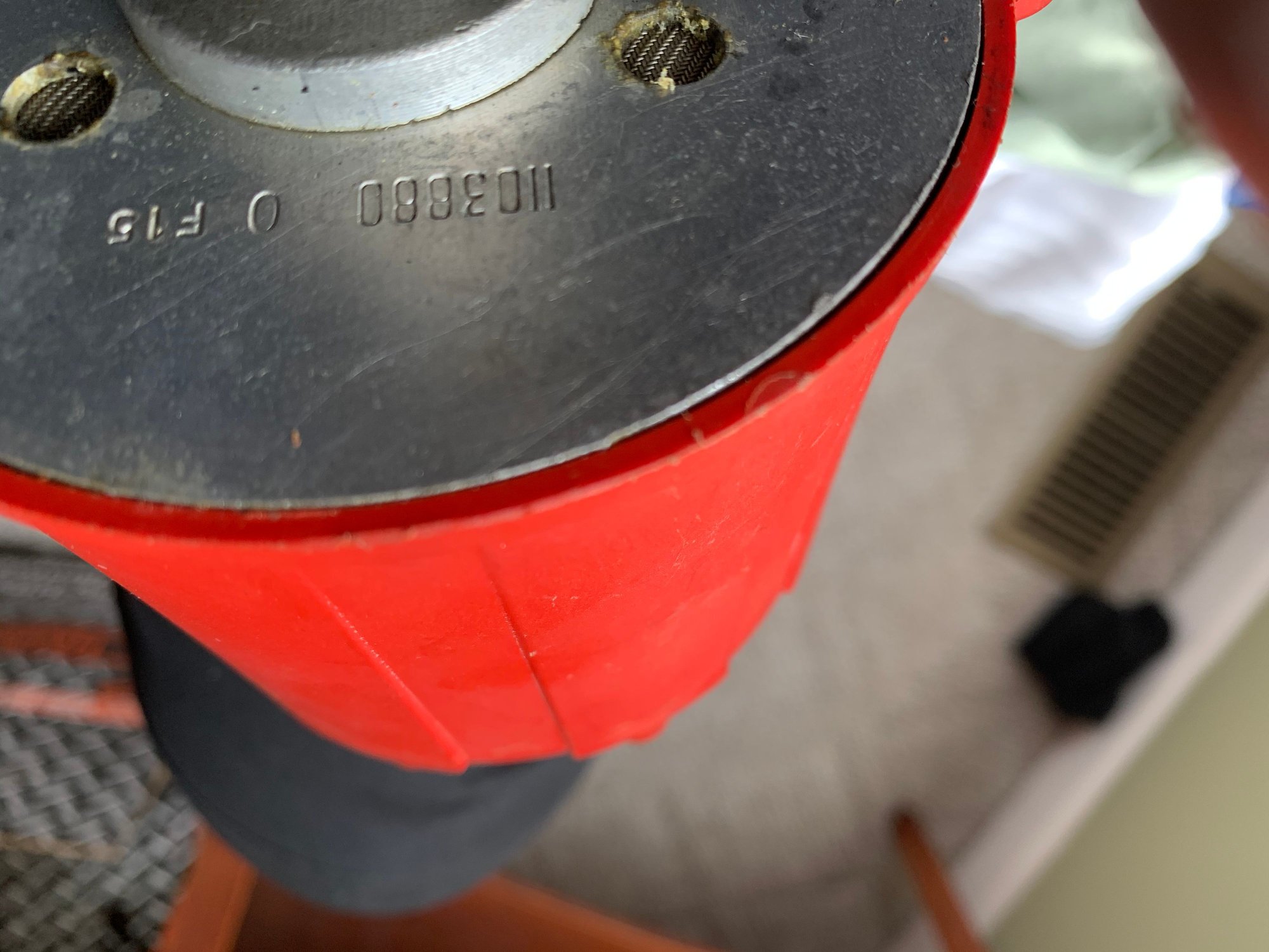

Supposed to be a 730 out of a Vette. EBL Flash P4. Not sure of the distributor. Came with the whole FIRST setup I bought about ten years ago.
I only find this part number as obsolete for GM pick ups.
Two inputs to distributor
Part #
