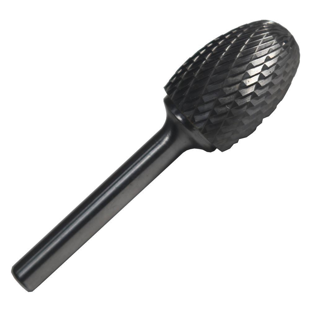

No need to pay anyone to port the plenum. You can get a large burr from a local hardware store ($10-$15 in the US) and use an electric drill - it'l go fast enough for removing aluminum.
Gasket match the runner openings to fit the larger runners and make it look like this in the front
