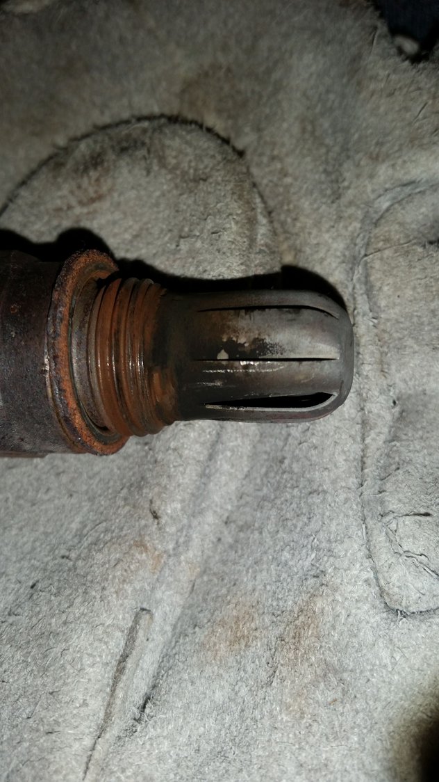

Progress. After disconnecting the sensor, the car starts and runs. Same as before the sensor failed, but it runs. Got it up to temp, but was far too worried about it dying to drive it. but it revs, sounds, well, it sounds its current normal which is fine for now. I pulled the sensor out and it looks like crap. Here's a couple pics of the offending thing. Got a new one on order for tomorrow.

Make sure the grounds on the back of the cylinder heads are clean and tight. One of them is a ground specific to the O2 circuit. Sounds like closed loop is trimming the fuel due to an O2 signal that's stuck rich or lean.

I will check those. The sensor may have failed due to the failed FPR which was dumping fuel into the plenum. Unfortunately, it had likely been failing for a very long time before I worked out the issue with the FPR. All that fuel may have just destroyed the o2 sensor.
