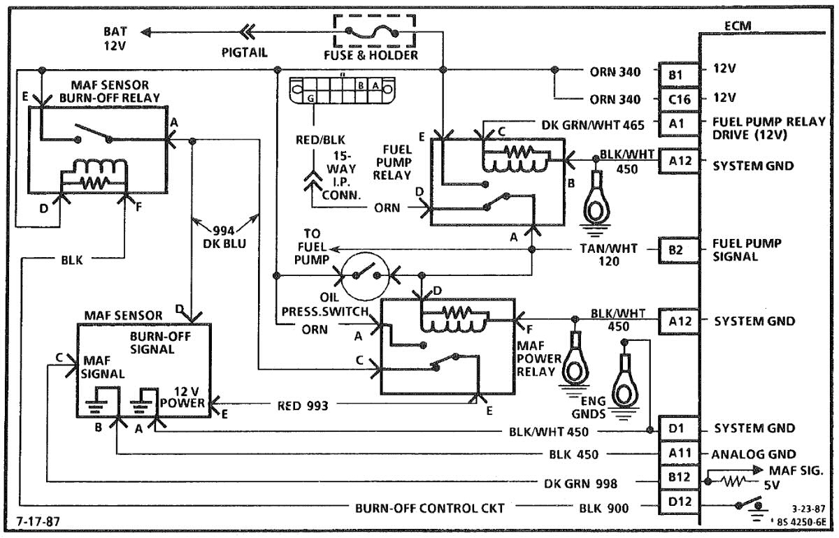

Verify the +12VDC supply at the MAF "E" terminal. Also verify a proper ground at the MAF "A" terminal. If the voltage and ground are not present, the MAF power and burnoff relays and their wiring need to be checked.

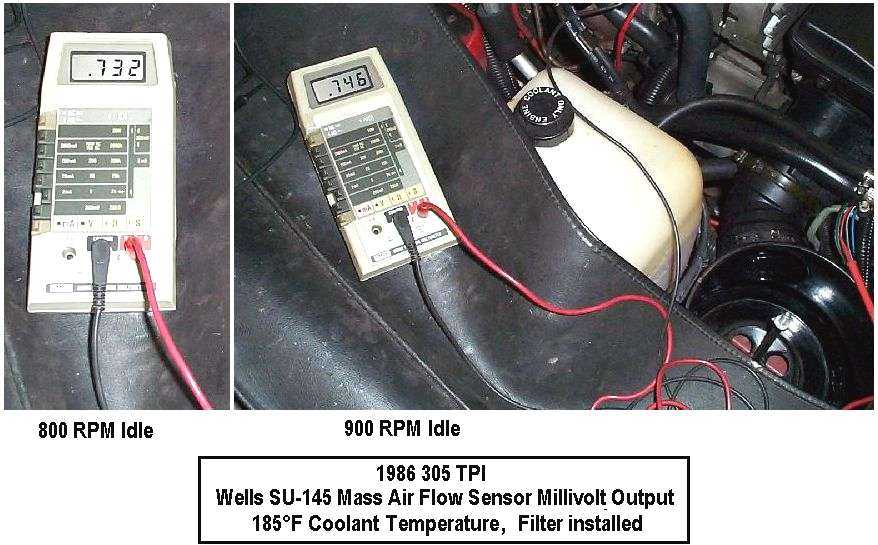

With the MAF installed and engine running at low RPM, measure the DC voltage at the MAF "C" terminal. Expect to measure around 0.75V at low RPM:
It may be possible that the MAF is under-reporting, and that will be indicated as a lower output voltage. If so, the MAF sensor can be cleaned, but manual cleaning must be done carefully.
After cleaning, the MAF output can be measured again for changes.

I tested the "E" terminal of MAF and have not voltage, (key in on position).
but yes negative in "A" terminal of MAF.
Wat is the next step? Tested on-off MAF relay?
Where is the on-off MAF relay?
what can I tested it??

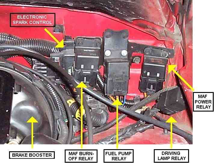

The relays are along the firewall, just below the windshield.
Your '88 will probably have a different type relay (rounded) and they may be arranged in a different sequence, so verify the correct relay by checking the wire colors.

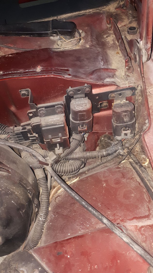

this is my car relays, they are different from your photo,what is each one and how are they checked?
