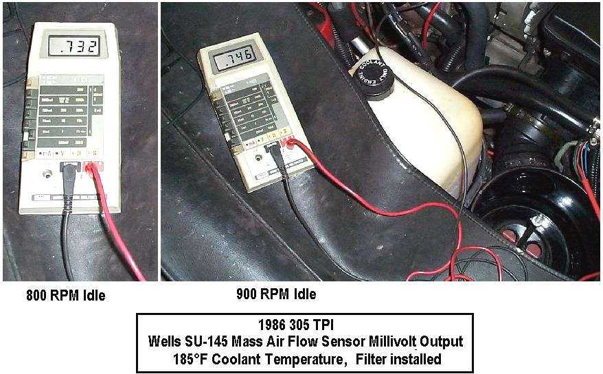

A running test can be perfomed with a voltmeter.
