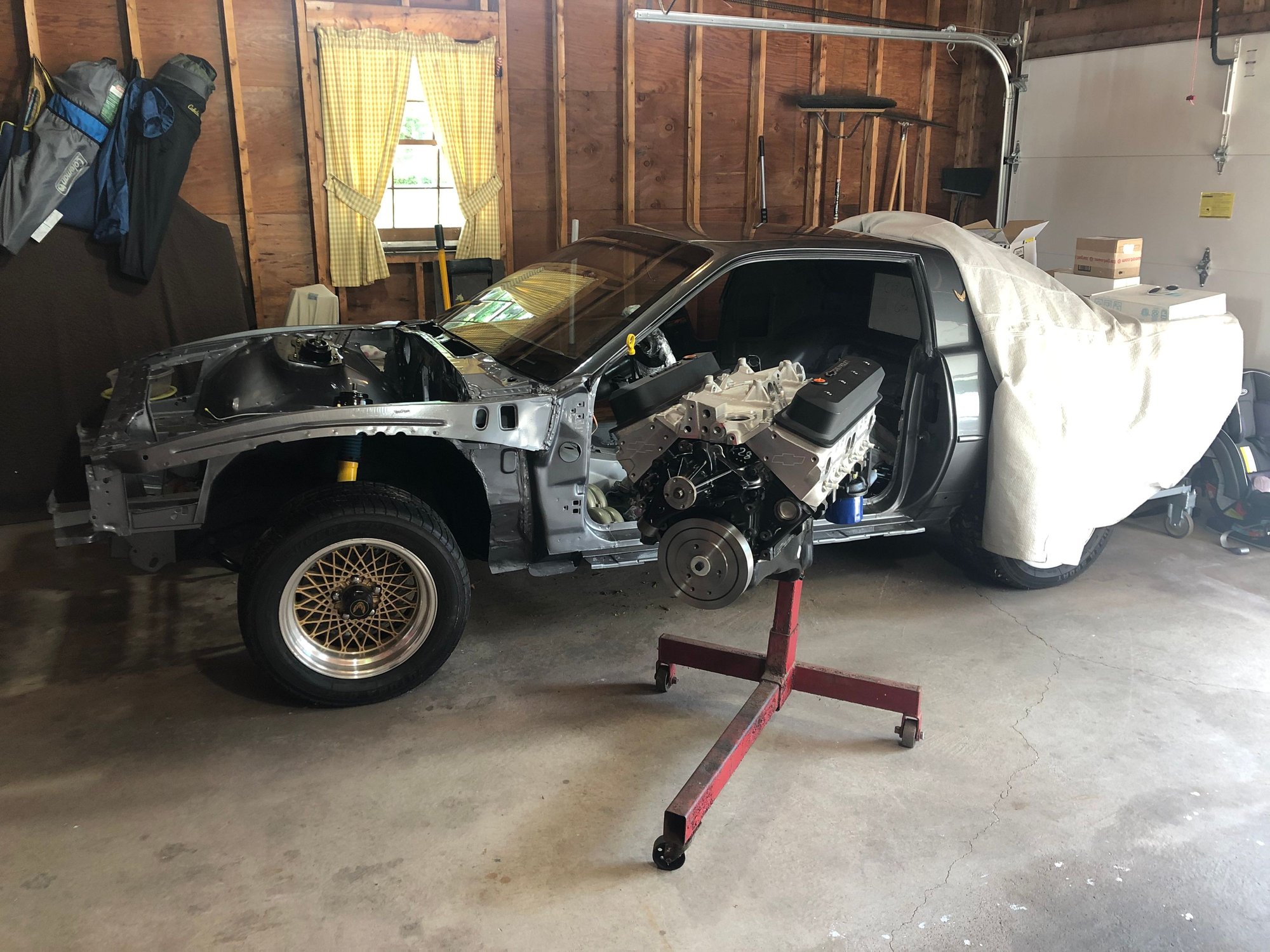

I have a GM Performance ZZ6 base crate engine that I will be installing a TPI system for my GTA. I pulled the 4 barrel intake manifold and HEI distributor and will be selling those parts off. The TPI setup is an SDPC Vortec manifold, Accel large tube runners and stock upper plenum, all heavily ported. Also 24lb/hr Delphi injectors, adjustable fuel pressure regulator and Dyno Don headers. It all bolts up just fine, but its not up and running yet, so I can't say how well it runs or how much power it makes. The ZZ4/5/6 camshaft works well with TPI and the key will be to port the TPI parts well enough to take advantage of the flow of the Fast Burn heads. I know it's not going to come close to GMPP's 405hp rating with a 4bbl carb, open headers and no accessories, but my guess is that it will be in the 350-ish horsepower range and probably 400-425lb-ft of torque. Plenty of power to have some fun, good reliability and driveability and look relatively stock (unless you know what you're looking for).
I wouldn't do this with all stock TPI parts though. It would be way too restrictive. I've had the Accel runners for years, so I just bought the SDPC Vortec intake and ported everything. If I didn't already have the runners, I would have either used a FIRST TPI intake, or a Miniram.
