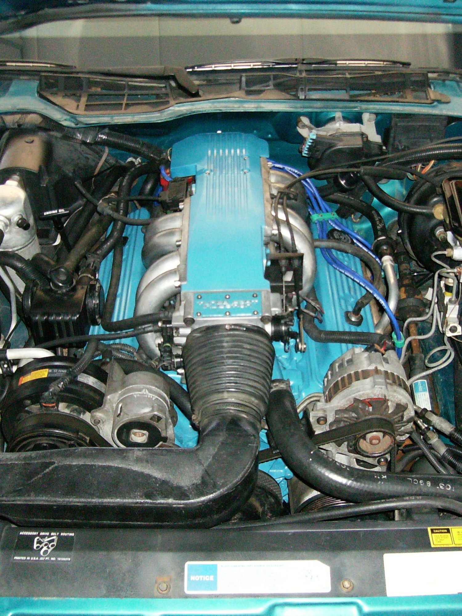

This was two months ago so maybe you figured things out since then but be aware there is a "top and bottom" to the valve covers. Meaning the center hold down bolts aren't exactly in the center... There is a fair bit of wiggling but they should drop in giving a clear feeling they are tight against the head. Your next magic trick will be getting the valve cover gaskets to not pop out of the rails as you flip them over and install them. I use a little piece of painters tape in the corners that I can slide out once everything is installed but clearly before I make everything tight,
Back to your initial question my valve covers and oil fill location look just like AliceEmpire minus the fancy blue paint.

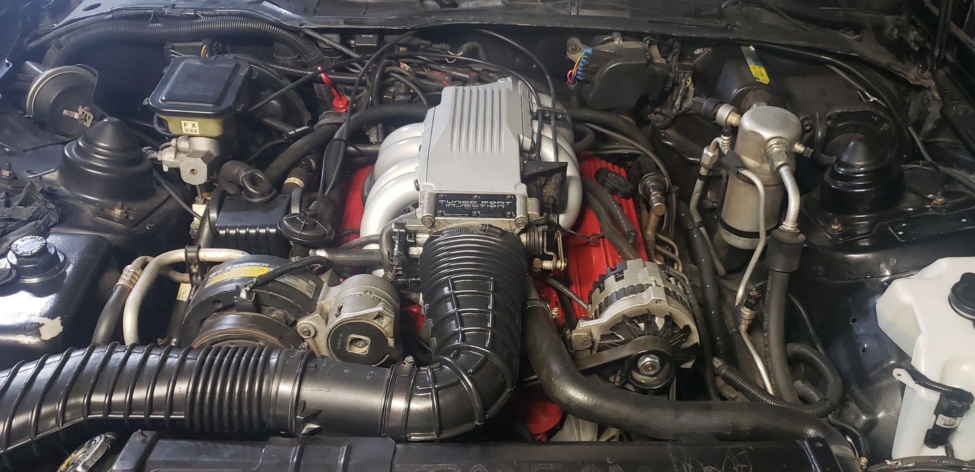

Thanks for the info! I did actually get it sorted and it did appear that at some point someone had just put them on the wrong sides. Mine are now also like in AliceEmpire's pic but with fancy red paint 😄

That's funny I looking at your picture and I thought I guess his phone reversed the picture because the brake MC and A/C were on the wrong side but then I realized everything on your motor was on the "right" side. I'm like, what is this thing in Australia, I look up and what to you know... Hello from the other side of the world.
I need to get my act together I just have the standard silver painted valve covers. I'm stuck in the stone ages. Glad you got it sorted.
