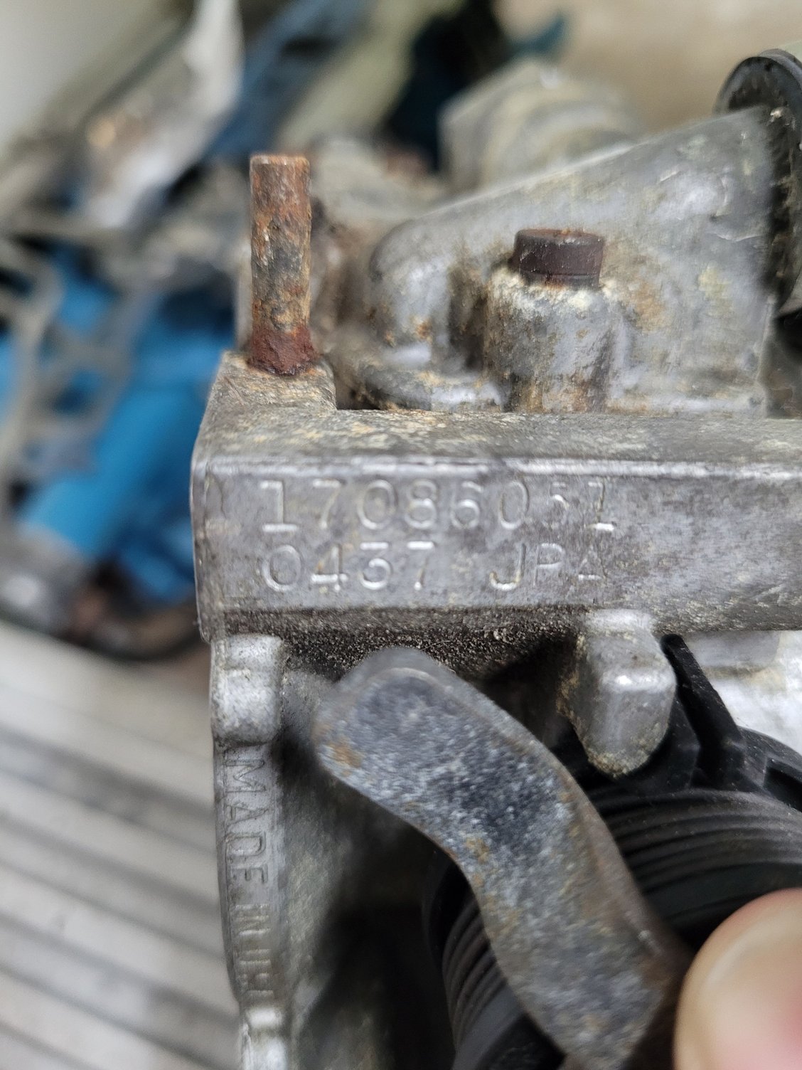

How can I identify what throttle body i have?
I purchased an intake that came with a throttle body. I was told its a 52mm but it looks stock but has 17086051 0288 JPA casted in the body and 75396 numbers on the blades. I can't seem to find any information on this. Yes I Googled. All I could find is throttle bodies for sale, no info. Anyone know anything about these? Thanks in advance

All GM factory throttle bodies are 48mm unless bored out in a rebuilding. Aftermarket are all 52 or 58. (At least I've never seen a 48mm Aftermarket) Those all look like gm cast numbers but if you really want to know, measure it.

17086051 is a 48mm stock gm throttle body. But that doesn't mean they didn't port it bigger

Txt me a pic or post it here of it from the front and one from the rear.

Judging by my crusty TB I pulled off an 87, he has a stock bore 48mm, and the julian date suggests it's an 88.
