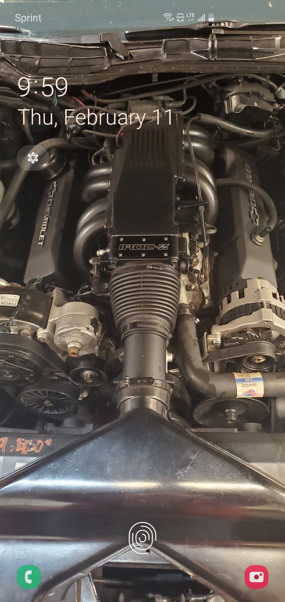

Good afternoon everyone I'm trying to finish my 1986 iroc z 28 t top car restoration can't find anyone in ct to help me. I want to keep the tpi and am having issues with keeping it running car came out awesome. Need to cross the finish line. Please let me know if you can recommend someone thank you. My name is Frank

Starts stalls on initial startup. Takes 4-6 times to stay running. Idle is erratic, when driving car will just stall.
changed from a 305 to 350 w a mild cam, aluminum heads headers, 28lb injectors

Do you have any data scans? Any chip tuning to compensate for the mods/are you running the 350 PROM chip? Check engine lights?

That is a beautiful engine, if Brian did the tune then you should be all set in that department. Get a paperclip and pull it straight, insert each end into the AB terminal (upper row, last 2 on the right) on the ALDL on the bottom of the driver side dash. Turn the key to on position, you should hear the fans kick on. the CEL will flash once then twice (code 12 telling you ECM is working and in diagnostic mode), it will do this three times, then if there are any other codes it will flash each code 3 times. Be sure to remove the paperclip before starting. That will at least point you in the right direction...If I had to guess I would think maybe a MAF issue or maybe TPS sensor out of adjustment/broken.
