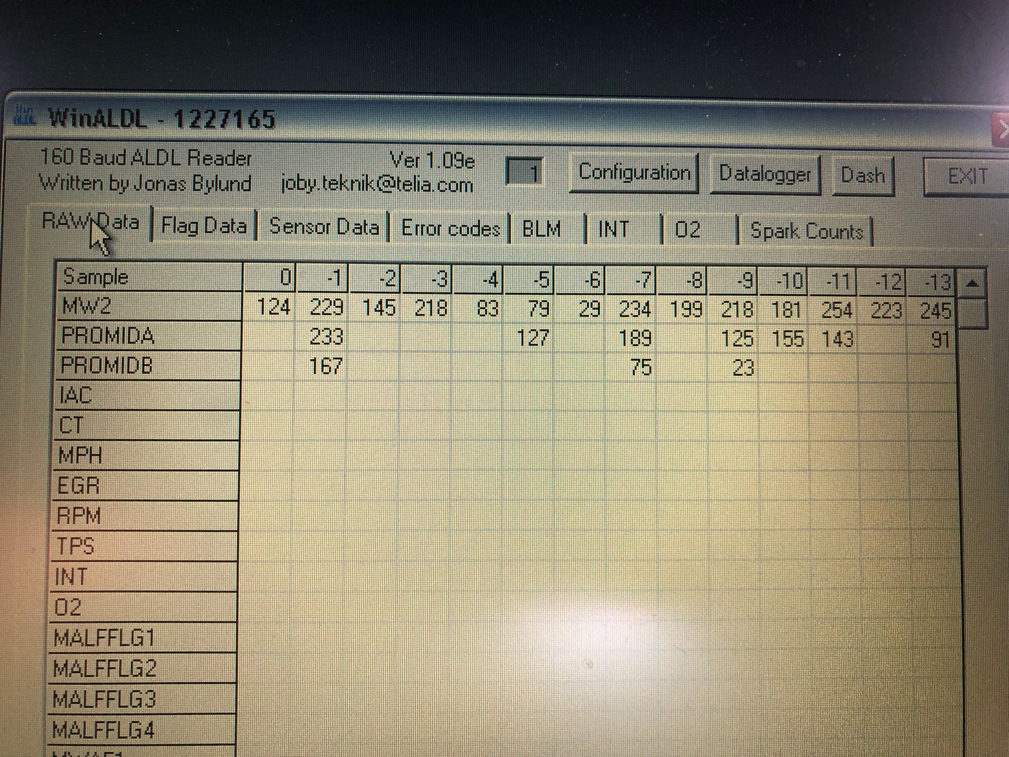

Finally got a cable to connect for datalog, but Im not reading out hardly anything, but then again I’ve barely touched winaldl before.
All I get is this?
Anyone have any input what Im doing wrong?

Nevermind, I found an error in the cable so now I got connected OK.
Would anyone care to take a look at the log files and see if anything makes sense ?

Nice work getting those logs. Looks like you threw a Code 44, which could be a lot of things but it's somewhere to start. Try checking some of these things:
https://www.thirdgen.org/forums/tpi/...ml#post2157371
Your fuel pressure should be good, I would also get an ohm reading of all the injectors and see where they're at.
I have also uploaded your longer datalog as a comma delimited csv so it's easier for others to read without conversion.

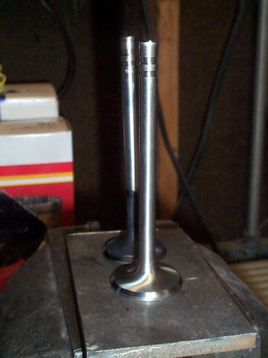

As I recall, the last time it was running a bit rough the #4 exhaust valve was bent:

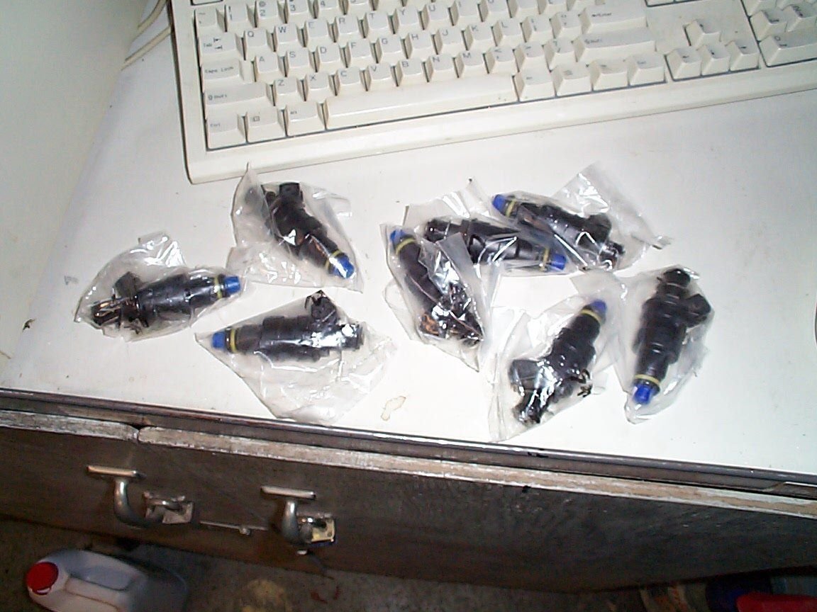

It can't be the injectors - They were just cleaned 19 years ago:

Yeah, and you know what, that car has started and pretty much ran perfectly for all those 19 years since you got her running So I guess it is acceptable if it needs some attention now I did have it apart couple of years ago replacing all gaskets, but that's about all that has been done to the engine.
Cant't believe you still had the pics

I'm i reading this correctly? The injectors were cleaned 19 years ago????? Is that a typo?

Pretty much Well, to be fair, they were actually replaced, not just cleaned - but yes, that was back in 2002 - has run ever since
You reckon it’s time again?

Technically, they were cleaned and flow-matched by rotating other stock injectors into the set. Half of injectors in the eventual set were the original RP injectors removed from the car. Obviously, the solenoids in those lasted a lot longer than Multecs. This was the injector chart:
It couldn't hurt to check them again, but the result of a streamer or dead unit wouldn't likely be the surging shown in the video. A stuck injector might do a little of that, however, A power balance test should reveal that.

There goes to show you to not trust my 19 year old memory You are of course right, I thought we went to get some new ones, but that may have been a new set of rockers.

You got a set of Crane roller-tip rockers. The injectors were cleaned/matched in Michigan, then sent back to me.

Alright, so here is an update,
I checked spark on one of the fouling cylinders, and had spark with a spare plug, but poor to none on the installed one. So, obviously the spare set of plugs I had swapped initially with was not good
So yesterday I got a set of new ones and it immediately sounded better and ran on all cylinders when running, yet still unsteady. But I kept at it until it warmed up, and then it actually ran smoother than in a long time - just with a high idle - but at least it would run fine on its own.
However, when starting it again today when cold, it would not run at idle again, and I have to keep easing on and of the throttle to keep ut running, but it does run on all cylinders.
So one problem is solved, but not the idle problem.
I've attatched two scans - one from yesterday when it had warmed up and was running smooth - and one from today when starting it cold and not able to idle.
Any of the readings give any pointers ? Or the fact that it does this only when cold ?
Since it ran smooth when warm, I have not bought compression & leak testers yet, would that still make sense to do, or just a $200 waste at this point ?
Thanks!
Ken

Old Oct 14, 2021 | 09:58 PM
Vader's Avatar
Posts: 19,679
Likes: 316
Re: Running very rough but no idle - video
If it has a smooth idle when at operating temperature, it should be safe to rule out the mechanical problems that would be diagnosed with a compression tester or cylinder leakage test. My guess is that the valve train and cylinder sealing are intact.
I haven't looked through the scan logs thoroughly, but I do note a persistent Code 44 for a lean oxygen sensor.
