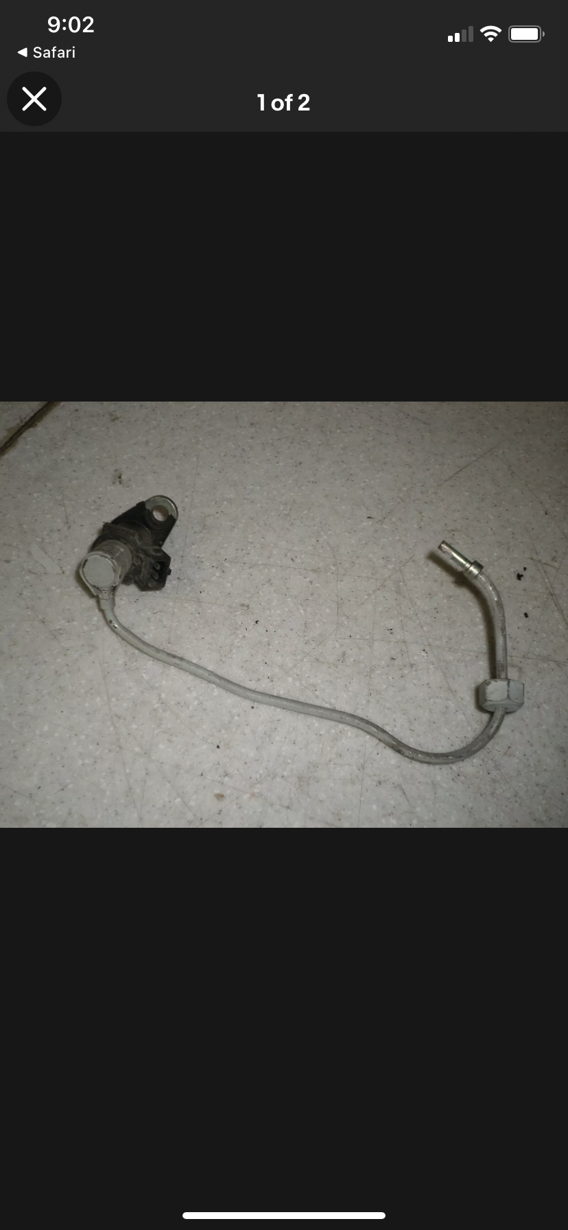

So I can see the hose going to the PVC. but that is a big hose and plugged in ok. So I am attaching a foto of the 9th injector. You will see the connector plugged in and will also see a red plug I put in the nipple I have mentioned. See what you think. Thanks

Feed pipe missing?

That is indeed the 9th injector, I’ve never seen one hacked up like that. I would just buy a cold start injector delete kit off eBay, roughly $30, and get that out of there. Be sure to check what they did at the back of the rail to be sure it won’t leak fuel. The kit I mentioned comes with a nice plug for the fuel rail too that won’t leak fuel.
Your next step is to get ahold of Tuned Performance on here or another reputable tuner and get a new tune/prom chip with 89’ programming to delete it. After that car will start faster and with his base tune run cooler and better. You can also get VATS deleted if so equipped and delete EGR or AIR emissions if already removed or have plans in the future to do so. Just my .02 but it’s what I would do and did on
mine. Also check to see if anything else has been modified.
If you want to keep everything original I think I still have my original cold start injector in my parts bin that I would let go for $65 plus shipping. It worked and didn’t leak when I removed it 4 years or so ago.
