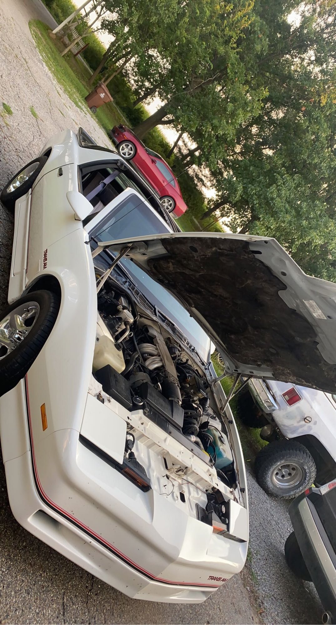

how do you switch from a single wire o2 sensor to a 3 wire. I have an 85 T/A that was swapped to a 5.7 tpi. It has headers and larger exhaust pipes, no cats. The exhaust does follow the same placement as stock would except its dual instead of a y pipe and ends right before the rear diff. Do I need the o2 sensor. I can't imagine there's enough back pressure for the o2 sensor if what you're saying is true. I haven't driven the car yet. I bought It as a project and it's very close to being done. So I even need the o2 sensor. I'm still learning and would appreciate any feedback thank you
