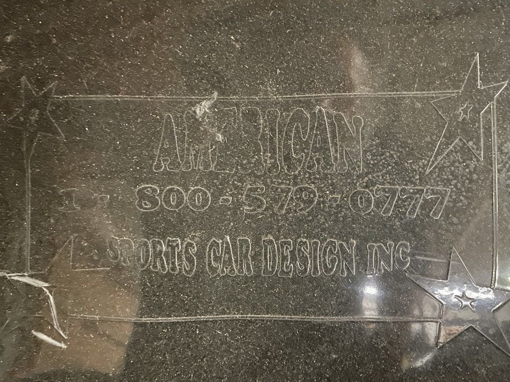

If that hood is from ASCD (there should be a label on the underside in the middle--two pics below), and if it's in good shape, and if you like it, then keep it. That ASCD-produced hood hasn't existed for many years. It's the good one. But now that style hood is produced in/by Duraflex, and the quality is reported to be very questionable: might be good, might not be.
That Trick Flow package looks beastly. I like it. You'll definitely need a good exhaust system. But I suspect most people who comment will suggest something far less radical.

ill be sure to check out that hood.
