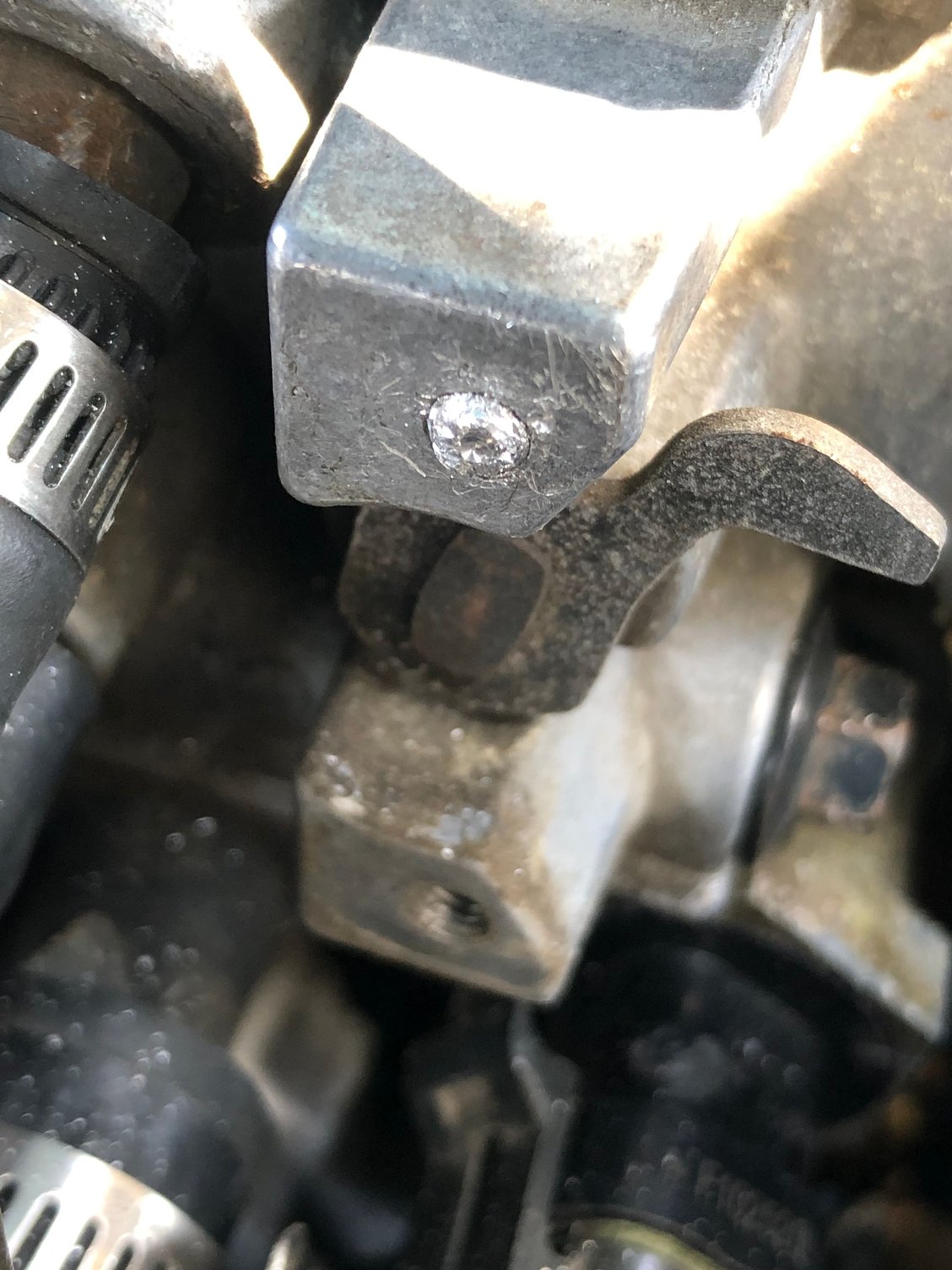

Thank you everyone who replied..
the finished product. New screws and tps. Eliminated the rough bouncing I had at red lights.
* Removing the original TPS screw was a high headache, part of me rushing to get my car running and enjoy it. I went to harbor freight and purchased a 10 piece extractor kit. It didn’t work. The drill bit just ate up the screw into fine metal. It even broke the extractor as I was turning to remove the Stuck bolt.
so plan b was to just retap the hole. I went to Home Depot and got self drilling screws #8 1-1/4in. After screwing the screw, it bottomed out. I was dumb and never paid attention to the TPS that it’s a thick piece and I didn’t have to keep going. But I was impatient and kept going and broke the self drilling screw in the first hole. There was no way of removing it.
I ended using the drill bit from harbor freight and literally retapped a hole right next to it. Then got the self drilling screw and made sure to no bottom it out. Wasn’t prefect since I had to use 2 washers and the moon shape washer just to accommodate for the space. I made sure to add anti seize to the screws. They are different because I thought using a hex would be easier since I can use a ratchet but the hose still is in the way so I’ll just always have to remove the hose if I want to loosing the bottom screw. Lost the 3rd hex screw so just used a Philips for the top.
I don’t think I’ll be messing with it any time soon. Going to buy a used one.
It’s unprofessional job and all because I rushed it. But I do recommend using better screws and use anti seize as mentioned but others. Just glad I didn’t damage the throttle body and manage to pull it off.
now to look into my code 43.
thanks 3rd gen forum. Happy Easter !

Re: TPS broken bolt throttle body
So I was told that using the self drilling screws is not the proper way. I had to retap it first since it’s a find thread hole and I’m putting a different thread screw. I’m not the smartest but if I can help others from my errors then I’m happy.
I’ll be buying another Throttle body and I’ll retap it the right way this time. But for now it’s works.
