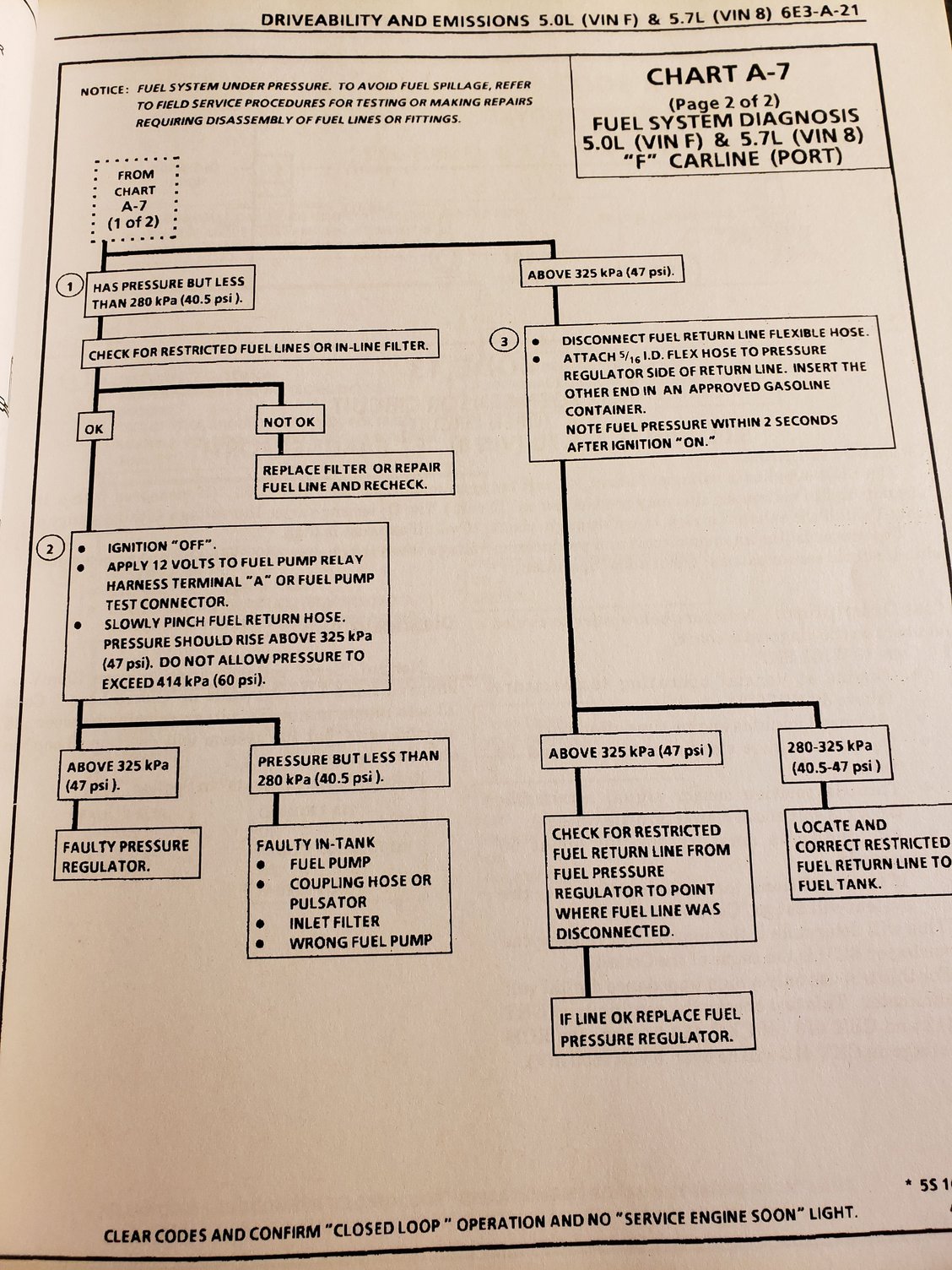

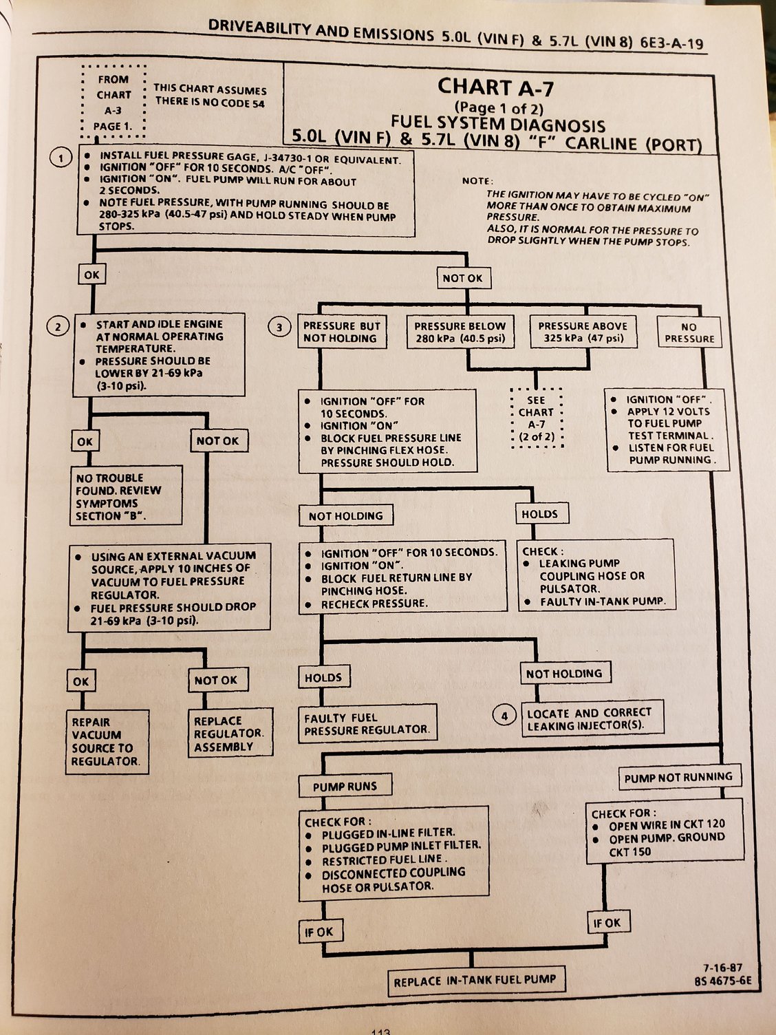

Take the cap off the Schrader valve on the passenger side rear of the fuel rail. Attach a fuel pressure tester and follow this diagnostic chart.
