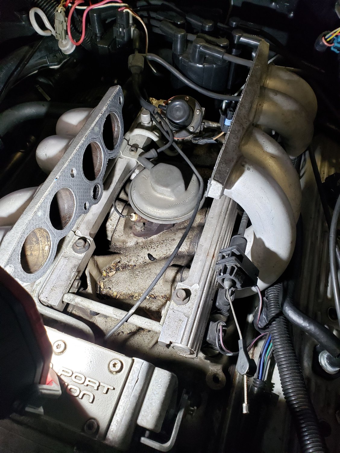

I'm am currently about to put my plenum and runners back on. I think I have everything correct, but I'm iffy on the EGR solenoid orientation.

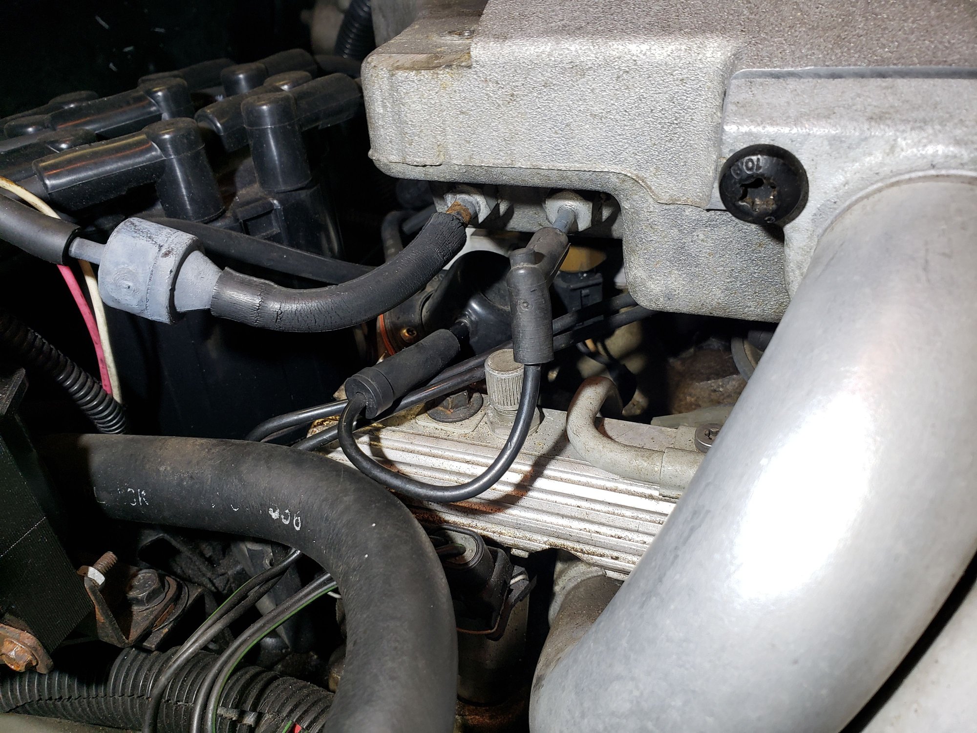

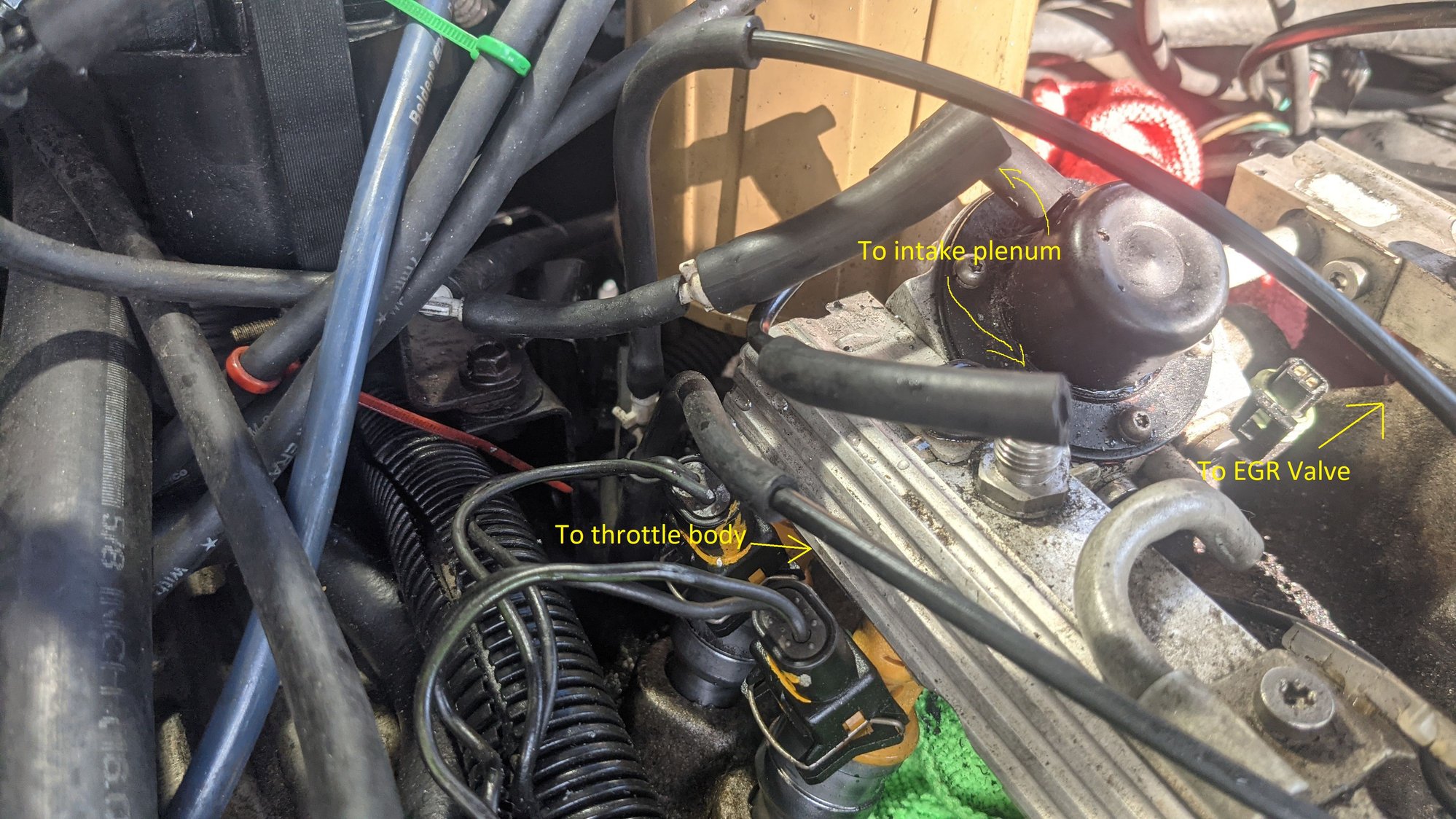

Here ya go

Looks like I need to order a check valve. Thanks for the pics.
