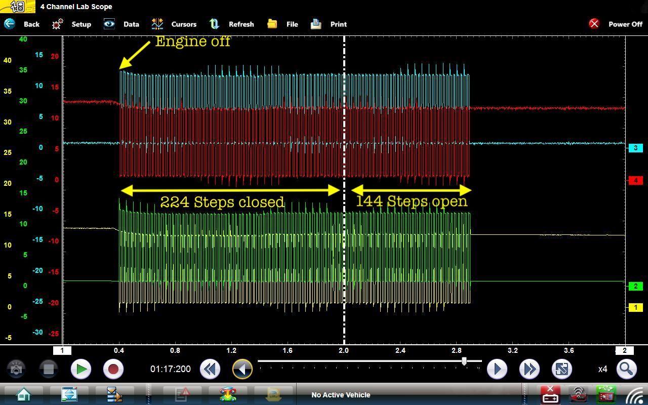

I recorded some IAC activity that I found interesting & has helped. I recorded the signal at the idle air control wires so I could see what its actually doing, or should I say being told what to do At start up of the warmed up engine, the iac takes 100-110 initial steps in from 144 within the first 7 +/- seconds, then as the idle settles in around 1000 rpms, the ECM will keep applying steps at a slower rate following its desired idle at the time based on engine temp, etc. What I didn't realize completely until now is once the engine is shut off the ECM closes the iac with (I counted) 224 steps to completely seat the pintle, then brings it back 144 steps so its ready for the next restart. This happens within 3-4 seconds.
This makes perfect sense why the minimum idle setting is so critical. The first start up is a combination of 144 steps on the iac & wherever the the blades are set.
The combination is going to determine how easy it starts & how well it initially runs the first few seconds afterwards as the computer takes control of everything.
if it doesn't start smooth its going to be trying all kinds of adjusting to make it right resulting in a rough startup.
Here is the activity. These are the steps I counted in my case, but still gives a good visual of whats going on when working as it should.
The second image is a zoomed in image of just the last seconds after the engine is shut off, that sets everything back up for the next restart.
