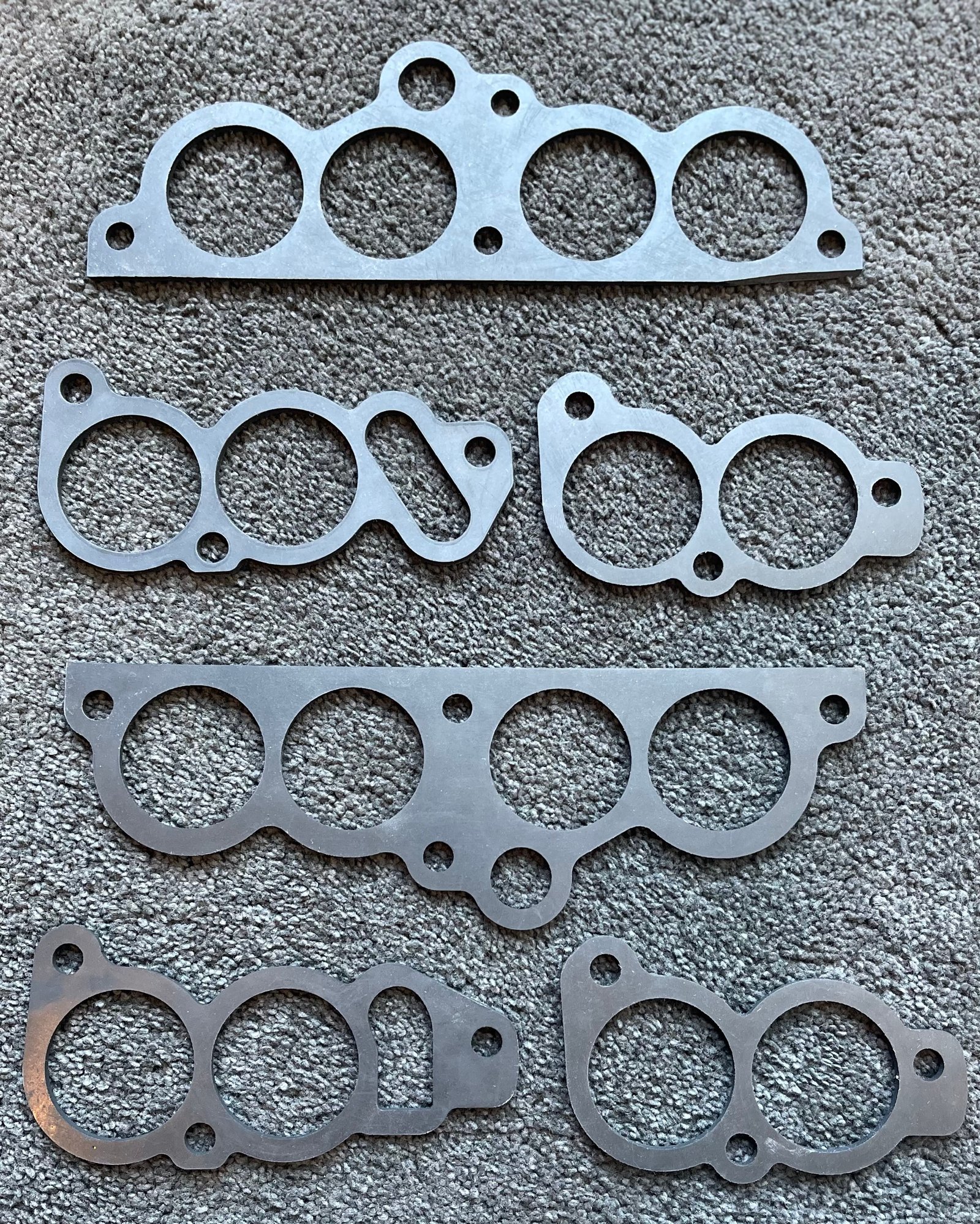

Hey text me 217-473-4998. I am SPR Performance. I do custom laser cut gaskets using Nitrile Buna-n Rubber. 1/8" thick material. I just posted on Facebook replying to someone needed the larger plenum openings.
Where about in central IL? Have a picture of your material?
feel free to text me at the number I listed
