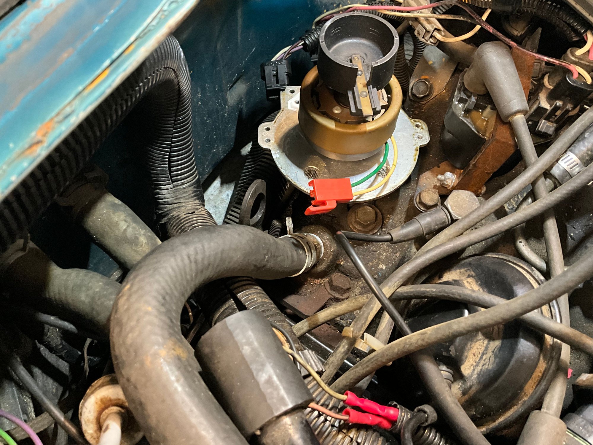

Old Mar 24, 2024 | 03:55 PM
Cztheday's Avatar
Joined: Feb 2024
Posts: 23
Re: No Spark to the coil
Sorry, not trying to be vague and really appreciate your help. Just have trouble articulating the answer to your questions.

Old Mar 24, 2024 | 04:04 PM
Cztheday's Avatar
Joined: Feb 2024
Posts: 23
I have 12v on the pink wire when, not losing power there
I’m checking the pickup coil now

Old Mar 24, 2024 | 04:18 PM
Cztheday's Avatar
Joined: Feb 2024
Posts: 23
It doesn’t read anything when I put it on ACV

Old Mar 24, 2024 | 04:21 PM
Tuned Performance's Avatar
Community Influencer
iTrader: (95)
Posts: 16,927
Likes: 1,016
From: Mile High Country !!!
Car: 1967 Camaro, 91 z28
Engine: Lb9
Transmission: M20
if you were cranking the engine theirs your problem. You could ohm it to double check.
Old Mar 24, 2024 | 04:22 PM
Cztheday's Avatar
Joined: Feb 2024
Posts: 23
If that’s the problem does that mean you have to replace the pick up coil or the whole distributor?
Old Mar 24, 2024 | 04:27 PM
iTrader: (95)
Posts: 16,927
Likes: 1,016
Engine: Lb9
Transmission: M20
You can just replace pickup coil, you have to remove and disassemble the distributor. It looks relatively new but despite it’s looks it should give a ohm reading and ac voltage while cranking.red lead on the com seems to be in the wrong spot.
