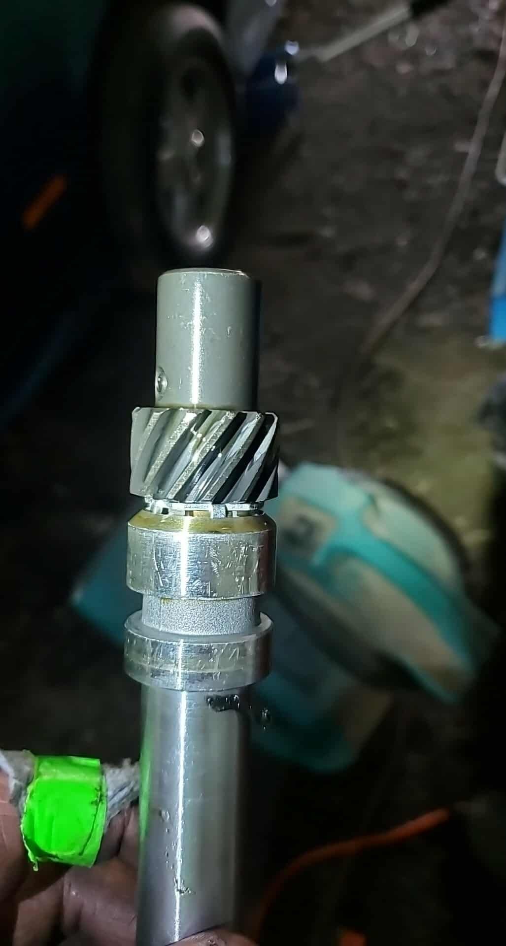

The hold down bolt for my distributor is either too long or stripped.. found the  Distributor loose and up a quarter inch
I think it was tight enough in the boar that when I checked it initially it did not spin and the time it happened to be in the right spot

Good find. There is a variable that not many would have guessed. The confounding thing is that the scanner will not communicate, which certainly doesn't point to a timing problem.

I'm still confused why it won't communicate, but as others have mentioned. Could be a bad connection or a pin in the ALDL loose / pushed out the back, or that the aftermarket chip just isnt compatible to communicate... I'll check into those later. But yeah I shouldn't be surprised.. whoever worked on this car before me was a complete hack and had no place working on cars.
I just wish I found it before I ripped it all apart.
