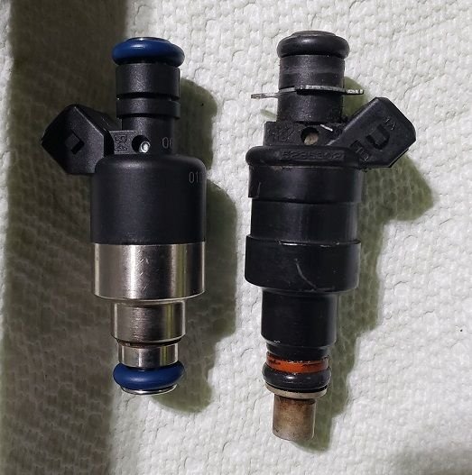

I had bought these 30# injectors from HolleyEFI for a 350 TPI, my question is, will these work? Just judging by the nozzle compared to the stock injectors, my guess is no. Holley on left, stock on right.
I had bought these because I saw that they had all of the injector data posted on their website that was perfect for input into TunerPro. So if they don't work, where can I find injectors similar to the stock style that have all of the injector data I need?

O-ring to o-ring appears the same. Clip position as well. Not seeing the issue

Yes that's all the same. My concern is the length of the nozzle. As you can see on the new one, it ends right below the o-ring, where the stock one extends further down.

Gm used multec and Lucas same dimensions as the Accel and Holley

Originally Posted by BrznGTO
My concern is the length of the nozzle. .
thats not an issue

Awesome that's good to know. Then I'm going to put these in the rails and put this car back together. Thank you all for the help!

Just make sure to tune for them or the car will be running ridiculously rich.

Yeah I will, thank you. I picked these because Holley's website has all of the injector data parameters that I see the L98 needs in TunerPro.
