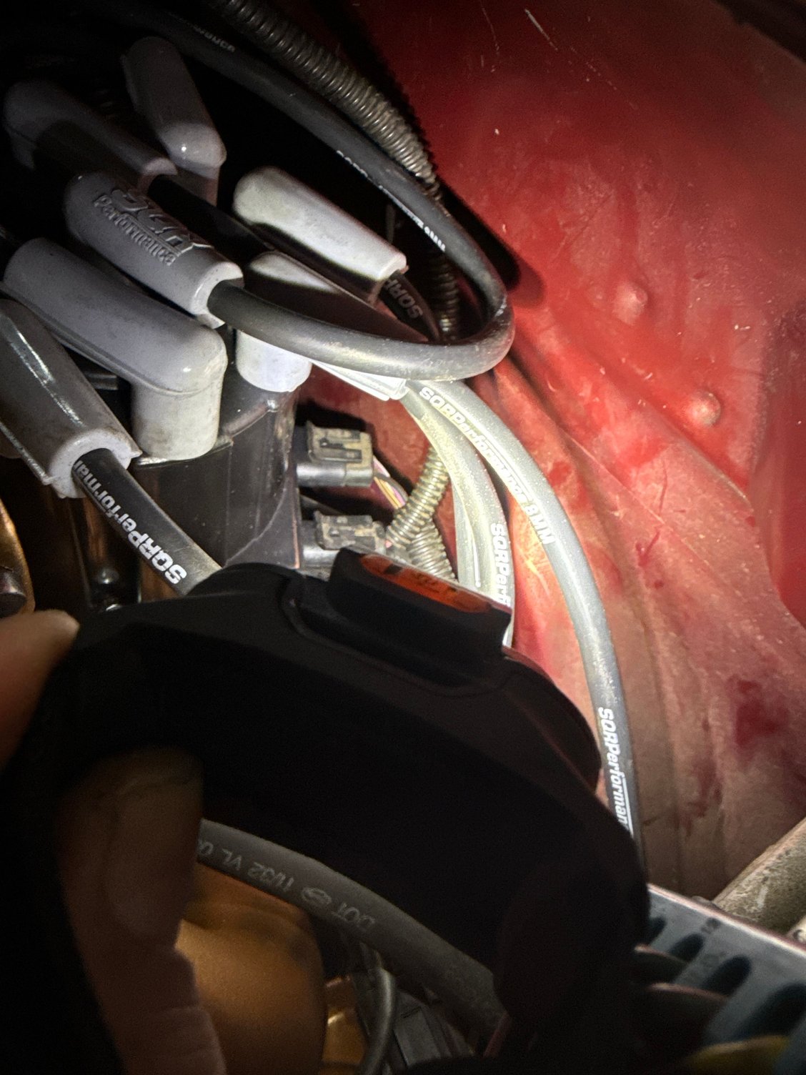

Ok fellas I have no spark. Just changed the distributor any initial ideas. I did ensure the ignition module which came with the new distributor is plugged up.
Old May 20, 2026 | 06:29 PM
Tuned Performance's Avatar
Community Influencer

Koeo power to the pink wire at icm from coil ?
what you mean that the other end of that doesn’t go to the air temp sensor in the plenum for the egr? I’m such a dumbass.
Old May 20, 2026 | 06:47 PM

The plug in is the same for mat but that won’t power the icm
i need this **** color coded and like computer wires. They only fit where they are supposed to go. lol.
Old May 20, 2026 | 06:51 PM

I’m think it is colored. Icm is pink and maybe white, mat is a pigtail tan and blk

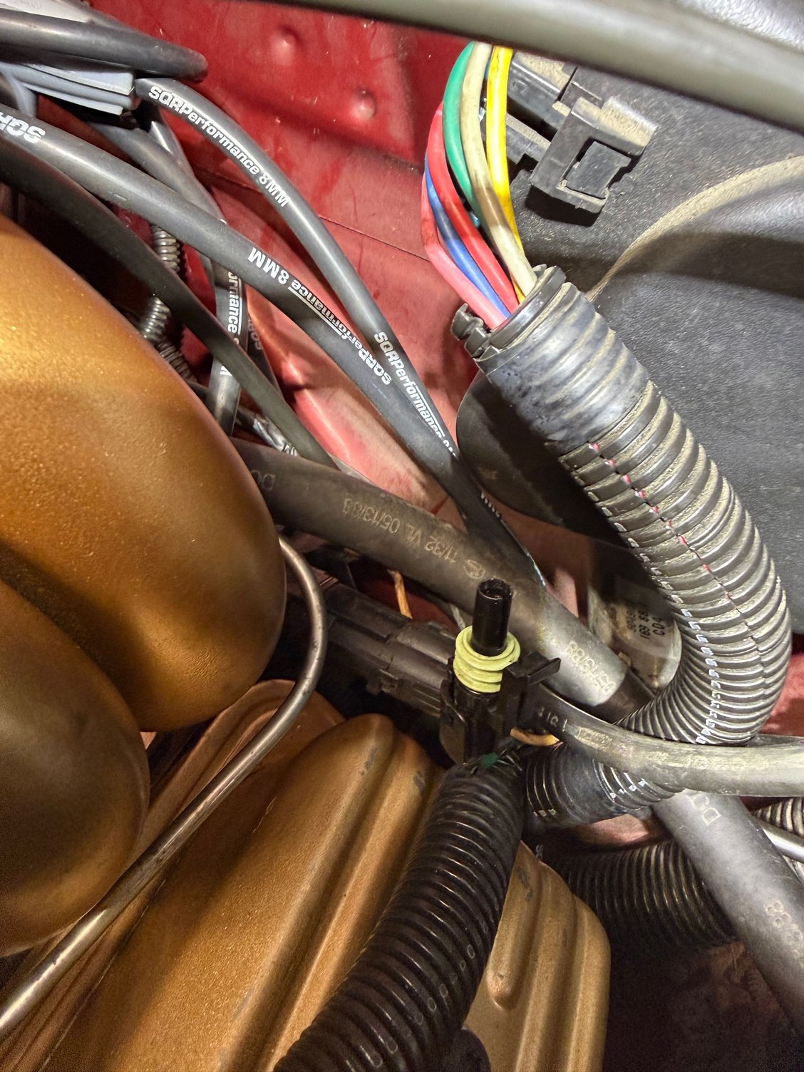

This is the one that I had plugged into the icm. I’m assuming it plugs into the temp sensor.
Old May 20, 2026 | 06:56 PM

Is it on a shorter pigtail, almost looks like yellow and blk for cts

This is what it runs to.

That’s mat under the plenum .

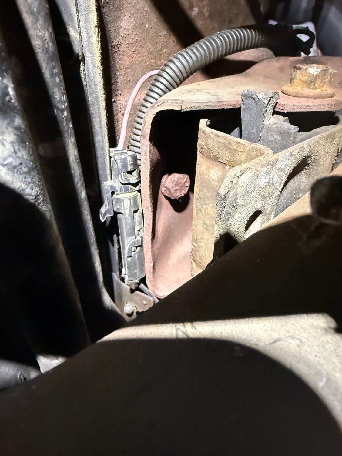

she started!!! Now what do I disconnect to set base timing?

The single wire tan blk next to the heater core

It’s been so long since I did a start tune it could be a fan switch tune setting , bad cts reading or bad ecm
or connection with prom. Does it go into diagnostic mode and blink a code 12 ?

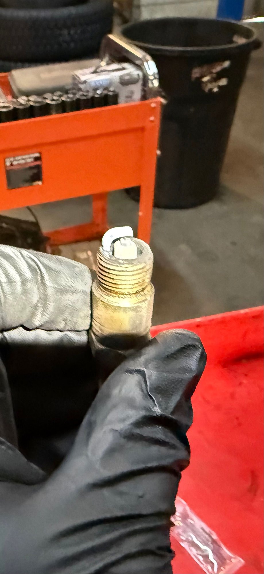

I’ve got a misfire it appears in idle or light throttle. I’ve removed plugs 1.,3,2,4 and they all so far look like this.

  #46
iTrader: (95)
Posts: 16,888
Likes: 1,013
From: Mile High Country !!!
Car: 1967 Camaro, 91 z28
Engine: Lb9
Transmission: M20
Re: The mystery bolt thread.
Looks lean what is int/blm
at idle in cl ?

Perhaps does this plug in have anything to do with 02 sensor not ready?
Old May 24, 2026 | 02:23 PM
  #48
iTrader: (95)
Posts: 16,888
Likes: 1,013
Engine: Lb9
Transmission: M20
If it’s a purple wire yes
Old May 24, 2026 | 02:25 PM
  #49
goldandblue's Avatar
Joined: Sep 2020
Posts: 99
Likes: 15
Car: 1988 GTA
It is green.
wire comes out of 02 sensor goes into a connector. Here is a pic of the connector. The harness that it connects to looks like it goes into the ignition module

Old May 24, 2026 | 02:41 PM
  #50
iTrader: (95)
Posts: 16,888
Likes: 1,013
Engine: Lb9
Transmission: M20
Might be egr temp sw, are you running headers ?
