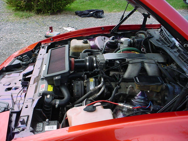

here ya go, this will display it.

I like that. Any info on that filter box?

its suncoasts ram air airbox

Hey, nice install .... what do you do for an MAF?

I dont know if turbulance is any problem, it didnt give me a whole lot more power, maybe a lil bit more top end, but it did give me ALOT more throttle response, over the stock intake.
When I had to get the MAF over there I was worried, I didnt want to cut and splice, cause even changing the length of a wire will change the resistance and all that, and I know thats how it takes readings. so I looked and tugged, and pulled it out of the loom it was in, and believe it or not, the stock wire will reach to that location. Just got play with it. I think it goes under my alternator. If your gonna do this I can take better pics of it for ya.
