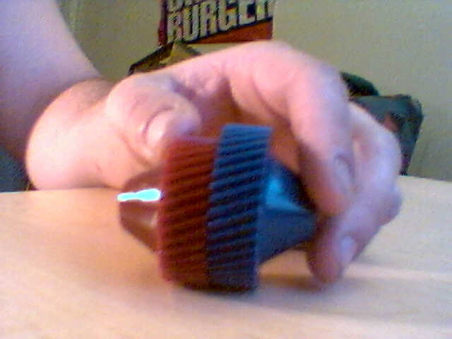

Hello. Had a bit of a setback with my VSS. I changed it to a 43t driven gear from the 37 (IIRC) when i went from 2.73s to 3.23s. Now a few hundred miles after the speedo gear swap, my VSS shaft snapped.
At first that struck me as odd, and i did some digging and found an old post where a user mentioned different VSS's for different size speedo gears. His idea was that higher tooth count = bigger speedo gear = more offset to the shaft. Upon quick inspoection, the 37t driven gear is noticeably smaller. (see attached pic) I can easily believe that much extra offset would have side loaded and killed the VSS shaft.
Now, does anybody know what the correct VSS would be for a 43t driven gear (with a red drive gear if that matters?) If i go to the dealer and get a VSS for a 92 L98 should i be ok, or were they grey drive gears with small driven gears? Any ideas, this is the kind of problem that i know the guy behind the counter will look at me funny and act like i am an idiot cuz he won't understand it.

Got the correct VSS today, GM PN #10456089
If i heard the guy right this is the VSS used on 41 tooth and larger driven gears, and it in fact has an offset shaft. If you're changing speedo gears from a 37t to a larger piece, you'll need this or you'll likely snap your VSS shaft like i did after a few hundred miles.
