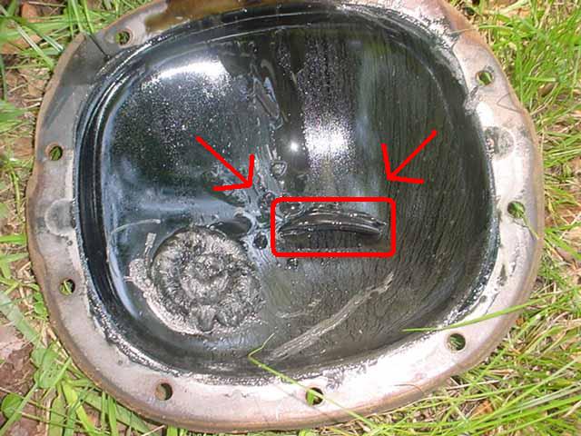

Opened my old rear up today....
Where's the missing tooth?
Old Jun 28, 2003 | 11:31 AM
Ovrclck350's Avatar
Joined: Oct 2000
Posts: 2,572
From: Longview, Tx
OH, there it is....
Ouch.... But I found it for ya
